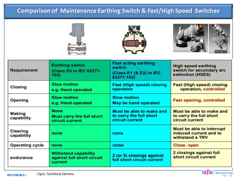

What is the use of High speed grounding switch in EHV GIS and in which location of the bay is it exactly used? Why only in line feeder bay? Some specs mention that both earthing and high speed earth switch should be able to make a fault..some specs say only high speed earth switch needs to have making capability.Pl advise.
