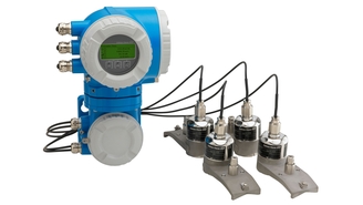

Looking for recommendations for a clamp on flow meter for polymer melt. Prefer adjustable from 1" to 4" pipe size and non nuclear.
Check with them, E&H and ask for a trial, unless they have experience with your product.

I'm just exploring, I was looking at the E+H Pierre mentioned above but that was just based on a quick google search. We've also looked at Vega Minitrac, but no everyone is comfortable with the idea of radiation.
I've asked my instrumentation guy for suggestions. This is for a special project so I wanted to come to the table with some suggestions before approaching him.

I was looking at this one. I didn't know there was the opportunity for testing. I've asked if my instrumentation guy has an account with them.
