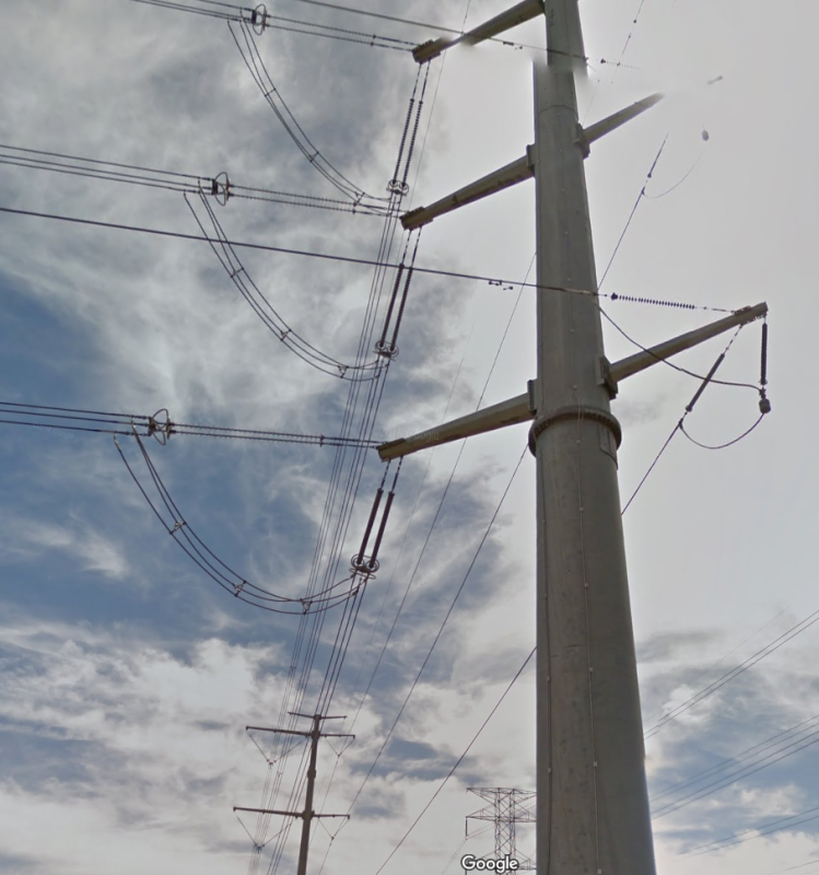

Which type do you think these are? Sort of seems like neither since it's only on one end of the insulators and does not encapsulate the hardware.
(500kV and 230kV btw)
wroggent
- the tower end is at ground potential. The line end of the insulator string is at line potential. That is why corona rings are just used at the line end.

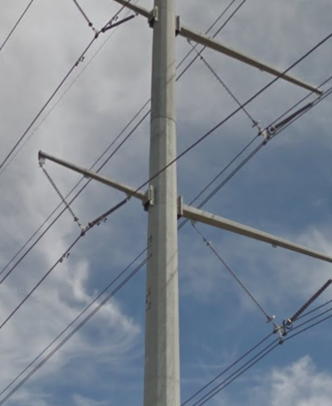

Thank you gentlemen, they are vibration dampers. I have been wondering abut these devices for 15 years. Now I found out.
Thank everyone
Just for the record if any future students stumble along, I found some up-close pics of the lines in my 138kv link. Believe it or not, it also looks like there are flash over protection "horns" incorporated as well.
 http://files.engineering.com/getfile.aspx?folder=c1c6a0a4-80d9-4971-b5ee-31552f0de4e7&file=line.jpg
