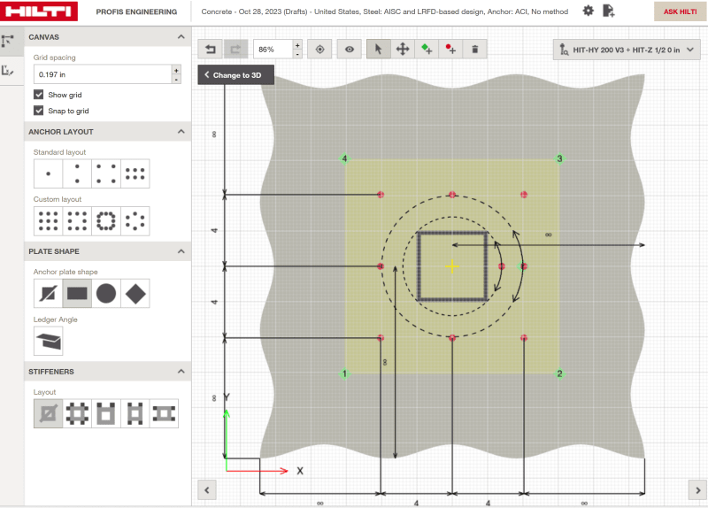

Anyone here use Hilti Preimium? Is it worth it? I looked, but does it allow to customize anchor bolt spacing/layout?
I see I can do 9 (3x3) but wanted to do 8 (without center) not sure how to do it.
My free version of Hilti Profis (not Premium) does what you're asking.
Yep. You can do whatever arrangement you want with the Canvas tool:

I did play around a bit more and figured out how to delete a anchor.
You are right for the baseplate/wallplate.

I took the plunge, and yes its pretty cool the way it can do the baseplates/anchorplates.
