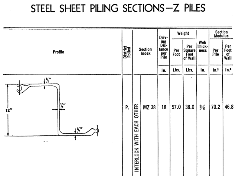

I am working on a power plant discharge structure that specifies MZ-38 sheet piles on the design drawings. Would anyone know where I could find dimensional data on this shape?
1950 US Steel Hot Rolled Carbon Steel Structural Shapes, Page 49 of 71
