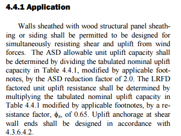

I'd like to revise the view that I expressed above regarding the use of sill anchorage to resist overturning induced anchorage:
What I implied: don't do it.
What I wish that I'd said: do it carefully.
Complications <> prohibition. I shouldn't be implying that things can't be done simple because I'm concerned about whether or not others will fully appreciated the issues involved. My bad.
On a related note, I'm curious to know how others are interpreting the last sentence of SDPWS 4.4.1 and clause 4.3.6.2. While I don't think that these clauses prohibit the use of distributed uplift connections for overturning, I feel that they indicate that the authors were envisioning these systems having discrete tie downs for the OT uplift components in excess of self weight.
1. For in-plane uplift, if the dead load is insufficient, the holddowns at the end "shall" be provided to give the required safety factor against uplift.
2. For out-of plane uplift, then the stud to plate connection in connection with the anchor bolts does function to resist any uplift if the dead load of the wall segment is insufficient.
I have always considered #1, but really never #2. I will concede that #2 does exist for walls normal to the applied lateral force.
Mike McCann, PE, SE (WA)

The way I read it is that if your first wall anchor is sufficient to resist the tension force then you don't need a hold down. Looking at the tables, this only applies to really light loads. It looks like a dumbed down version of a perforated shear wall.
Never have used this section of the code and probably never will.
