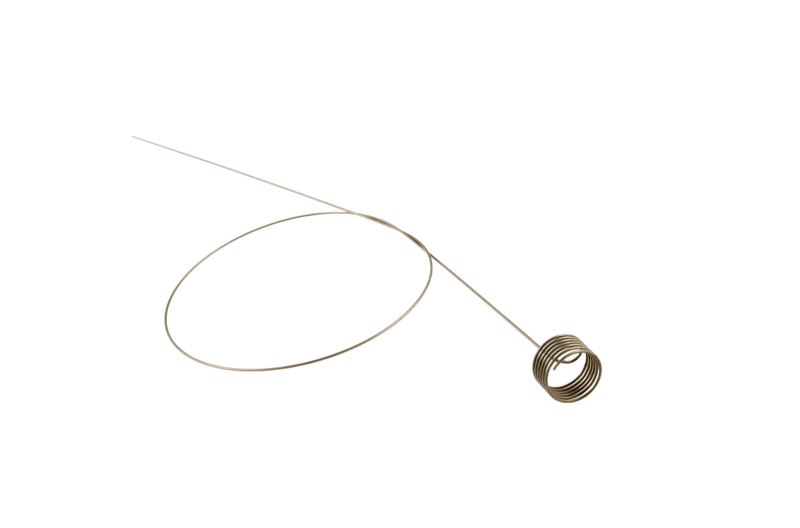

Have any of you put a trailer hitch on a unibody car? They typically come with these cool wires with coils on the ends for fishing the bolts thru. Would not need much of a hole to use this system.

A window probably is possible. It's a 16" HSS so plenty of room for an access hole. I don't know that the fish wire would work for the vertical bolts, or at the very least it's a little tricky. Once you pull the bolt through you need to unthread the wire without the bolt dropping back down, and then hold it while you get the nut on. You'd probably lose a few to the internal hss graveyard.

I imagine you would lose a few but so be it. Mechanics magnet on a stick is helpful for holding the bolts or just jamming a screwdriver into the side of it.
