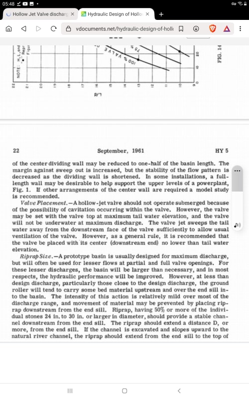

In the dam of a hydroelectric plant there is a pipe to discharge the ecological flow. See Figure 1. The entrance to that pipe is at an elevation of 270 meters above sea level (masl). The maximum water level in the reservoir is 290 masl and the minimum water level is 280 masl. The pipe has a diameter of 0,80 m and a total length of 40 m.
A few days ago, the reservoir reached its maximum level and the operation of the valve was tested. The flowmeter associated with this pipe registered a reading of 4,5 m3/s.
The Contractor argued that the flowmeter was giving an erroneous reading, given that the flow to be discharged with that maximum head should be 8 m3/s.
Over time, the level in the reservoir dropped and, for now, it is not possible to verify the situation: if it is the flowmeter that gives the error or that the pipe does not actually evacuate the 8 m3/s.
According to hollow jet valve discharge tables, with the dimensions at stake: reservoir head and pipe diameter, it is possible to evacuate 8 m3/s.
But, in the technical literature on these valves, as shown in Figure 2, when the valve is connected to an outlet pipe, the length of this pipe must NOT be greater than 4 times the diameter of the valve.
Here the question arises, can the length of the outlet pipe be the cause of the flowmeter reading?
Can the value of 8 m3/s actually be delivered or not by the valve/pipe?

This doc says that hollow jet valves must not be placed in a submerged condition to avoid cavitation. Cavitation in your valve would limit or reduce flow.
A high backpressure on your valve is hydraulically similar to a submerged condition, so the length of pipe producing packpressure on your valve must be limited. Does your tail pipe configuration produce a backpressure greater than 4X D_valve? It looks like that's a yes, so according to the reference, cavitation is probably occurring and reducing your flow rate in the system.

I have a different interpretation why your flow is lower than expected.
The hollow jet valve needs to be ventilated with ambient air to fill the conical void downstream of the valve. With higher back pressure than the valves intended application the ventilating air will be lower to non existent. The following may occur, both will have negative impact on the valve and discharge pipe service life.
[ul]
[li]Two phase high velocity flow in the discharge pipe. Pressure loss will be much higher in this pipe than single phase flow calculations show.[/li]
[li]Two Phase flow water hammer (slugging).[/li]
[li]Less than design damping of cavitation, possibly causing erosion at or near the valve.[/li]
[/ul]
Inspecting the valve and pipe for erosion after a period of usage is recommended.
If it is possible to move the valve to the downstream end of the pipe, the pipe and valve may flow much closer to the intended design. If you decide to install a water turbine, you still need an emergency discharge valve.
