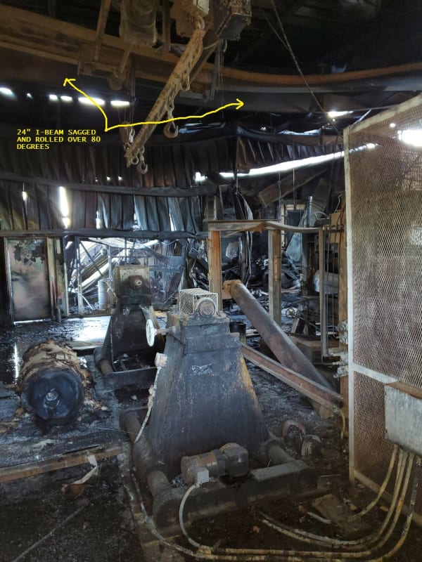

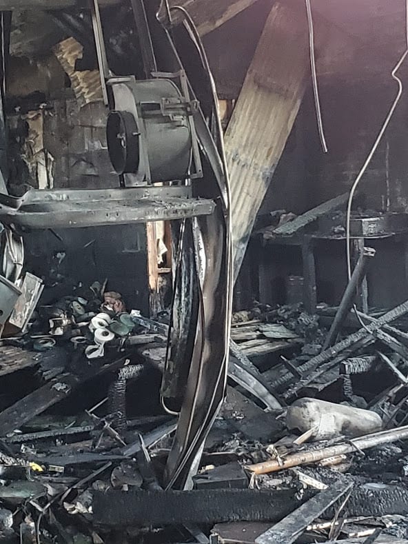

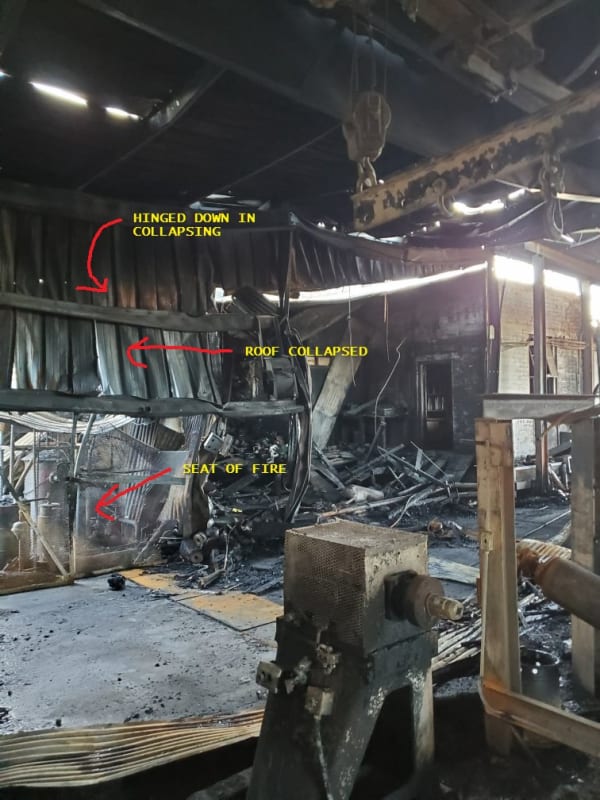

A customer of mine with a large facility had a horrendous problem a week ago. An oil heater used to heat-trace failed and caught fire. The place got cranking. Every fire engine in a city of 150k was called in (14) and they had about 20 hose lines going.
General mayhem.
Seat of the fire.
I-Beam.

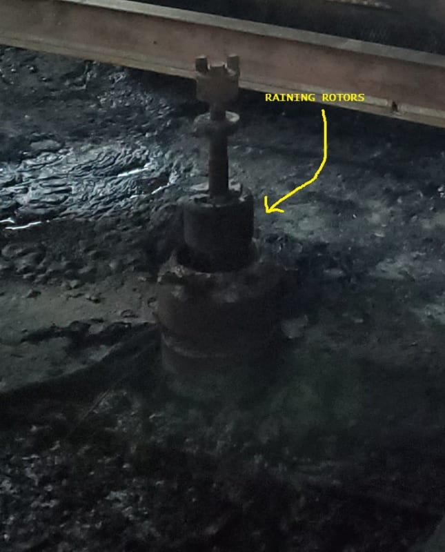

This was odd. All the overhead motors were gone. Well, their housings anyway, but they all left their rotors standing on end on the ground under where they were mounted. What happened to the housings?

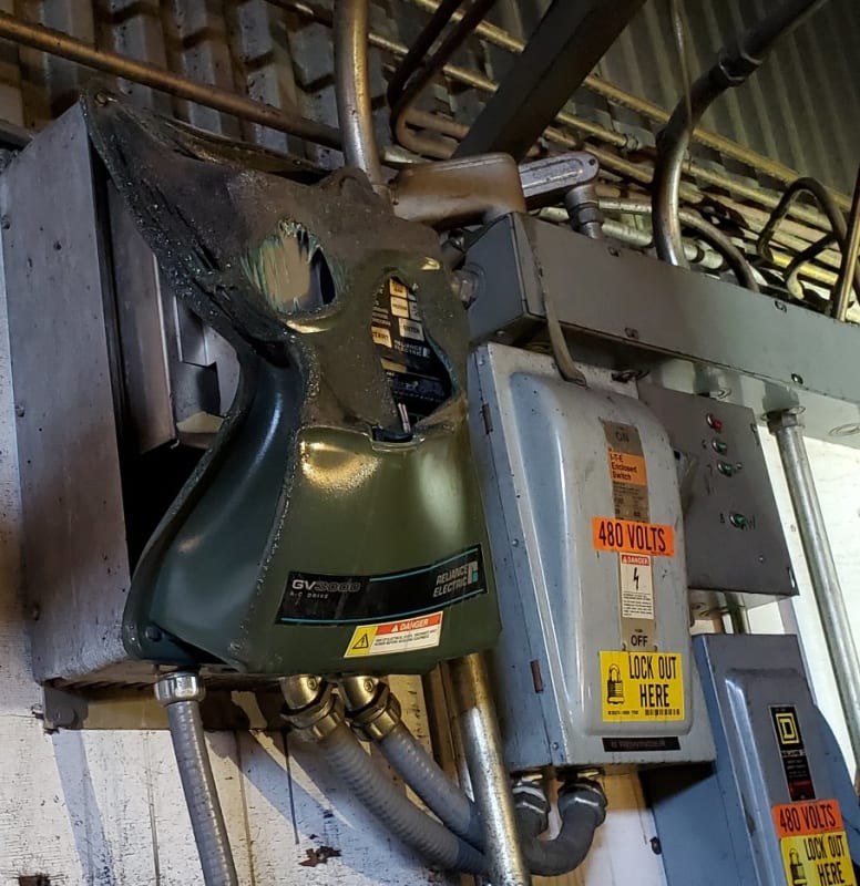

VFD's didn't fair well.. Everything around them looked okay but if you open breaker panels you see all the breakers have slagged back into the panels.

BUT WAIT! It gets better! After all those engines had pumped tens of thousands of gallons on the fire for more than three and a half hours the question "How can this still be burning!!??" was raised by the fire staff. The answer is simple..

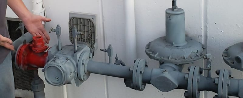

PG&E didn't bother to turn off the 2-1/2 inch 3.5psi gas line into the seat of the fire. Even though it is literally the first thing one comes to when driving up to the facility. It's estimated the damage was double it would've been if the gas had been turned off when the PG&E representative arrived.
Aluminum stator housings, no doubt.

Aluminum stator housings. Hadn't thought of that. That would explain it.

They would know if the PG&E workers shut off gas to the building because they would be waiting at the shut-off; and since the gas shut-off doesn't require any tech to do so, the FD should have shut it off themselves if they'd done the prep work.
These should be mandated: Fire Safety Gas Shut-off Valves.
"Operation: The valve is held open by a stretched wire containing a fusible link. When the temperature rises above 165°F, the link will melt and the tension of the internal spring closes the valve."
