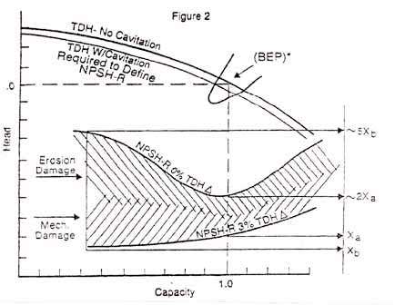

You also need to remember that NPSHR is NOT the cavitation limit.
This is at a higher pressure / head than the NPSH curve which is defined as the head vs flow where the differential pressure drops by more than 3% compared to no limit of inlet pressure. If you've ever gone to pump test, when they do NPSH you can often hear the cavitation start before they call the reading for the 3% differential head loss reading.
The usual margin is 1-3m , but at higher flows and higher pump speed this can increase to 5m or more above the NPSH curve..
This is one mf my favourite graphs. The bottom line is what your pump curve says. the top line is where cavitation starts.
I think your pumps are also not balanced so that one could be pumping a lot more than the other on or two (you haven't answered those questions yet).
