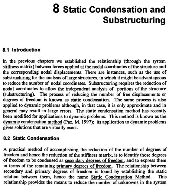

The method of DOF reduction is commonly known as static condensation. There are many places where the method is described but Mario Paz's book dedicates and entire chapter to it. In the olden days, it was used for sub-structuring large buildings such as the John Hancock tower. In recent times, you mostly hear of it in relation to dynamic problems where it is sometimes deemed expedient and appropriate to condense out the DOF which have no mass assigned to them.

To clarify, I'm not suggesting that structural engineers need to go around condensing the stiffness matrices of their structures in routine practice to simplify them. Modern computing power makes that unnecessary and the faliability of human brain power would make it a quality control nightmare. I've only tabled DOF condensation on order to;
a) answer OP's original question and;
b) perhaps defend the reputation of this professor who is apparently an "idiot" because he or she is a civil engineer.
