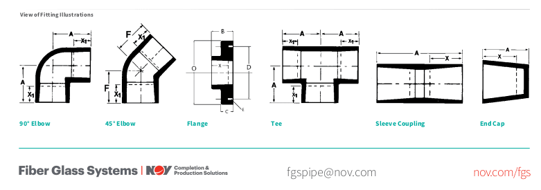

How can FRP pipe be connected to carbon steel pipe?
Mr. Weldstan can you please elaborate.
Or glue.
Flanges for GRP exist as either stub type and backing ring or solid GRP.
Ask you pipe vendor.
Victaulic style couplings might be an option. You could goooogle it...
Regards
Mike
A GRP flange mated to a steel flange and bolted together with a gasket in between.
Flanges will work, make sure the mating metal flange is Flat Faced and the gasket is full face, as with a raised face flange it is possible to crack the flanges by over tightening the bolts.
