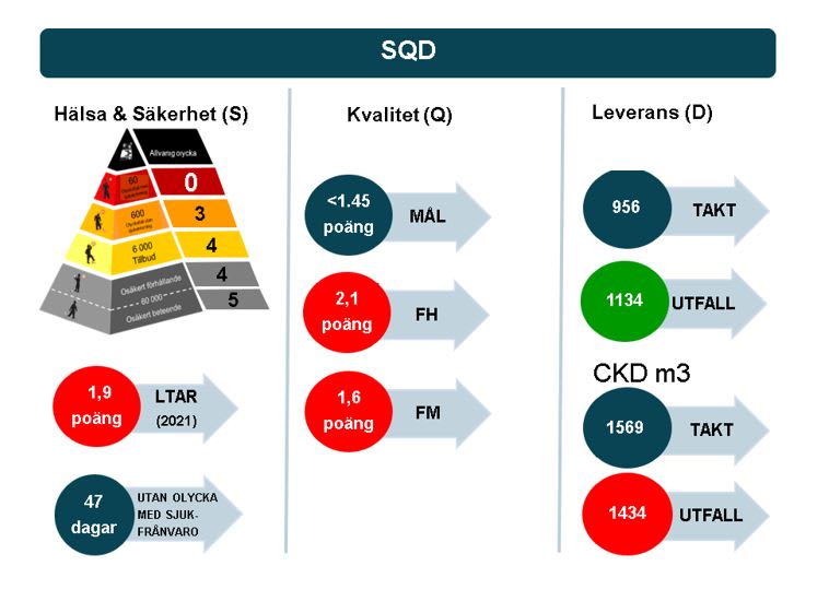

We use something called SQD Safety Quality Delivery
Before we wrote this reports on preprinted small papers, for Uncertain Conditions, Uncertain Behavior, Incidents, Accidents and Deaths.
Now we are suppose to do it via an app, I think the reports have declined with at lest 4/5 since then, nobody asks for them anymore.
Before they did it every morning on the morning meeting but not anymore.
