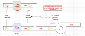

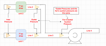

Imagine you have two ducts (ducts 1 and 2) that merge into a single duct (duct 3). There is a fan located on duct 3 that needs to pull air through ducts 1, 2, and 3, and then exhaust it through duct 4. Both ducts 1 and 2 have obstructions that cause a pressure drop of 7 inches of water column (7"wc) each. Assuming these obstructions are the only cause of pressure drop, would the fan need to generate a suction of 7"wc or 14"wc? I am trying to figure out how pressure drop works in series.
Hopefully this process diagram I made clarifies my imaginary setup and question.
edit: As it has been pointed out below, I was mistaken when I referred to the above setup as "in series". The setup is in parallel. I changed the title to avoid confusing anyone else who stumbles on this thread. Thank you to everyone who pointed that out to me.

The way to look at it is that the pressure at the connection point of line 1 and 2 to 3 can only be one value. So if both lines 1 and 2 are taking flow from atmosphere at 0 psig then the flow in each branch 1 and 2 is determined by the pressure drop in each branch (restriction to flow). In your example you show that the line losses are negligible but there is an equal pressure drop (restriction to flow) in each line segment across some device. Therefore there will be an equal flow in each line segment because the flow will increase in each line segment until the pressure at the common connection point is the same. This assumes that the both units 1 & 2 give the same pressure drop at same flow and are equally sized. Now if the unit 1 and 2 were different sized and produce different pressure drops at different flow then the flows in each line 1 and 2 will be determined when the pressure drop is such that the same pressure exists at the connection to line 3 as there can only be one pressure at that point.
For parallel flow (what you show above) the pressure drop at the common connection point must be same. Pressure drops don't add for parallel flow but are what they are in each branch independently of the other but where they combine they must be equal. So if the intake is at atmospheric in your case the pressure at the common connection point is negative 7" wc. at the given flow. So if the fan discharges to atmosphere it must develop 7" wc differential pressure.
If the two branches above were arranged in series so that the same flow goes through both units 1 & 2 then the total pressure drop adds and therefore would be 14 inches wc total and pressure at connection to line 3 would be negative 14" wc., so differential pressure required of blower would be 14" wc for discharge to atmosphere.

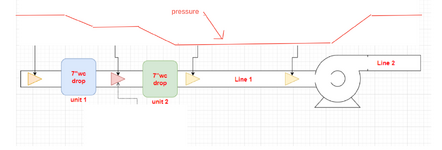

Embarrassingly, after rereading your post for about 30 minutes, I finally got it. The way I now like to think about it is in terms of inlet and outlet pressures. The outlet pressure of both units 1 and 2 is created by the suction of the fan. This suction pressure exists in line 3 and therefore exists in lines 1 and 2 after units 1 and 2 (as you explained in your post). If this suction was -7"wc, then it could overcome the pressure drop resistance caused by both units 1 and 2, since both units 1 and 2 would have an outlet pressure of -7"wc.

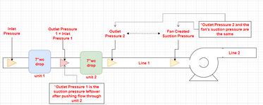

Where this way of thinking really helps me is when used and compared to pressure drop in series. Take the same example but with one line (line 1), unit 1, and downstream of unit 2. The suction created by the fan (-7"wc) is the outlet pressure to unit 2 and is enough to overcome the pressure drop resistance caused by unit 2. However, to do this would require all the energy available by the suction; therefore, there would be no suction left to overcome the pressure drop resistance of unit 1. In order to do that, the fan would need to generate a 14"wc suction (-14"wc). 7 + 7 - 14 = 0.

I also made updated diagrams to again help explain my nonsense.

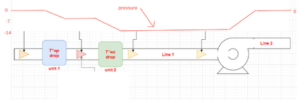

The pressure will look like this:
Exactly. Because units 1 and 2 are in parallel so pressure downstream must be equal.
Yes, the suction pressure would be negative 14" wc at suction of fan since this is the total friction loss in the total suction line. The pressure between the units will be negative 7" wc since this is the pressure drop across unit 1 and upstream pressure is atmospheric = 0" wc.
You are right! But I knew this. Granted, my understanding of the relationship between flow and pressure could easily be used as an example of the Dunning-Kruger effect. I just find it easier to understand if I think of the suction as something consumed by the pressure drop. I know it is not technically correct, but it helps me visualize the pressure drop as a barrier or a block of mass, and the suction pressure as the force required to break that barrier or move that block. Once the barrier is broken, the flow can proceed through the line/system.
That said, your graphical representation of the pressure is very helpful in understanding what is actually going on with the gauge pressure, so I thank you for that!
