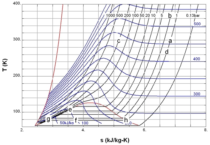

I may be off base here, but when I learned thermo, I look at these equations as 2nd law statements. Based on your equations shown, the statement is, that it is possible for more work to be done in an open system as opposed to a closed in an isentropic system. So that leads me to the question of, where would this addition work come from in an isentropic system. If you look at the T-S diagram below and follow the lines of constant entropy and move from one isobar to the next, you have changed the enthalpy. To me it seems intuitive that one would expect a higher delta work in an open system than a closed, which is what the addition heat capacity ratio would seem to imply. In other words, there is an additional exchange of enthalpy that is occurring.
In a closed system the work on compressing a non-flowing fluid is the integral of (P dV) = Force x Distance = P*A*dX
Where PVk = Constant or P = C/Vk
So the integral is (C/Vk)dV - The solution to this integral is the equation for closed flow in your table.
In an open system the work is the integral of (V dP). This can be seen by the steady flow energy equation as follows:
TdS - W = dU + d(PV) + dKE + dPE = dU + PdV +VdP + dKE + dPE
But in a non-flow closed system we know that any heat added or removed Q = TdS = dU + PdV which is also true for a flowing system - so in a process with no heat added process such as an isentropic compression as the pressure increases and the dU increases due to compression, the integral of PdV is negative, because V2 is smaller than V1, but of equal value as positive dU so they all cancel - so PdV is still the pure compression work (that goes into dU) but VdP is the total work of compression and pushing the gas out of the cylinder once the compression has been completed, and pulling new gas back into the cylinder for compression - note that PdV is called the area under the curve and VdP is called the area behind the curve in thermo books.
so TdS and dU + PdV cancels out of the above equation for steady flow and the resulting steady flow equation is:
VdP = dKE + dPE + W
Typically change in kinetic energy and potential energy are negligible so the equation reduces to:
Integral of VdP = Work Steady Flow
The soliution of this integral is the equation shown for an open system in your table.
