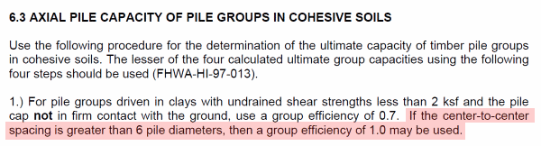

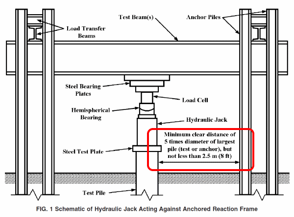

For minimum distance, I would use a clear separation between the wall and closest pile of 5 pile diameters or 8 feet, which ever is greater. This is the same minimum required for:
a) Federal Highway Administration calculations of pile group efficiency to be 1.0 (no interaction).
Note that 6 pile diameters center-to-center = 5 pile diameter clear separation
b) ASTM-D1143 Axial Pile Load Test clearance between anchor piles and test piles.
