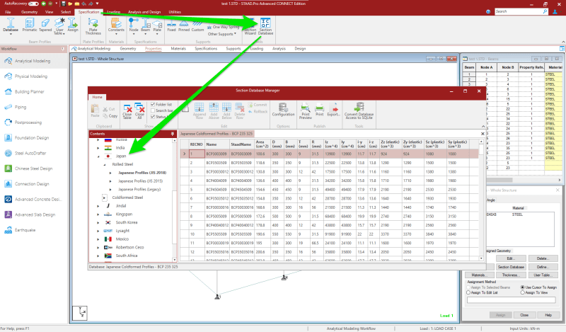

Hello Sir or Madam,
I am very new to staadpro and now I want to assign Japanese steel light lip C Channel member in staad pro as shown in the image. but I cannot find it. I found only C Channel in Japanese steel.
Considering that lip channels are barely used as structural elements in Japan, STAAD.Pro does not support this section as for now. To see all the sections available in STAAD.Pro please refer to the image attached. However, STAAD.Pro allows users to freely create their own sections. Please watch this video to see how you can do it.
