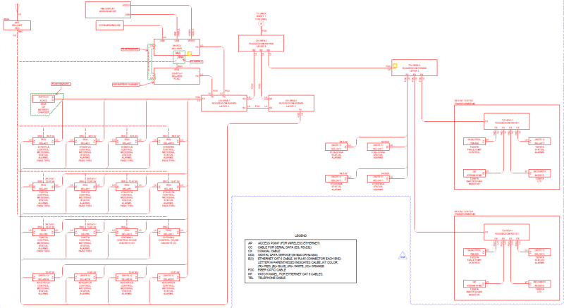

here is another drawing. I kinda understand the logic when it's explained to me that this relay is connected to that relay and they all are interconnected. but how can I reach an understanding that this specific arrangement is correct or not? and if some items or parts or signals is missing, i must be able to point that out. where should i begin to study the architecture of this?
In the 1st drawing, the FT cut-out is on the more negative side of the relay, while others are on the more positive side. This is a client preference / standard. As an example, some users prefer to isolate both sides of the contact for ease of testing, which requires 2 blades - one on either side of the contact. This, by the way, makes testing safer as a test paddle (ABB FT) can be inserted and tested with the relay test set with wet contacts. Also useful if there is not a ground referenced DC supply. I suspect in this case the test switch on the more negative side is a relay fail contact to SCADA. If OUT101-106 were used for something, one might argue that the test SW on the (+) side is useless for testing. Ex. When the SW is on (-) side and SW is open, a Voltmeter can measure contact state with respect to ground on the jaw side- if the contact is closed, Fluke would read (+~65VDC on 125VDC system). If Out101 is a trip contact and breaker is closed, ~-65VDC would be measured on blade side -up from NEG rail, through CB Trip Coil and 52a. If that SW is closed, the CB would trip.
The second drawing is a communications overview. I can't zoom enough read details. It may be SCADA related, or if its IEC61850 based, thats past the 101 series of P&C lessons for today :)

thanks. for drawing 1,would someone be able to learn this by self study? if so, are there courses out there that might help to speed up learning the inner workings of a relay? and the network connections, how the architecture of relay interconnection with SCADA usually is arranged. things like this.
yes, we do use iec81850.

It's entirely possible to learn through self study, or perhaps as mentioned above being assigned a project that's way above your ability or comfort level. I took a job with a company 21 years ago with a communications degree (mV, mW) and got thrown into the bears den "marking up drawings", which was really retrofitting digital relays in place of electro-mechanicals. I had never seen a single line drawing, a three line drawing or DC control schematics for a utility MV swgr. It was incredibly stressful as my work was started by a previous employee, there were deadlines and the guys in the shop couldn't start their work unit mine was complete.
Again, mentioned previously, modern digital relay design is much simpler from a DC control / wiring perspective. I would see if you could hunt down old Electro Mechanical control schematics for transmission line protection. Since the devices were discrete, there's a lot more going on in terms for not only tripping, but fault detectors, zone timers, blocking/steering diodes, reclose initiate, block reclose, breaker failure initiation, preventing reclose from a SCADA or local open, etc.

Networking relays and such is not terribly difficult. There are maybe 4 different communications mediums used. Some are point to point (plug relay into communications processor with serial cable), some are multi drop (plug a string of relays into a communication processor / plc), some are point to point fiber, some are ethernet based, so plug the relay into a switch / router. There is a network security side of things that may or may not be handled by IT. Often there is a redundant path for mission critical communications such as Transmission protection (Power Line Carrier + Fiber or ??) or in the station, such as your 61850 network diagram. BTW, all of this is very easy if it works.. It's the troubleshooting where you tend to learn things.
The inner workings of a relay are SW and HW. From the HW side a digital relay has a few components -A/D converters (VT/CT to 1001001), Opto Isolated inputs, CPU, memory, Output contact drivers. Some relays have more I/O, more A/D, more LEDs & pushbuttons, etc. The inner workings of the SW algorithms may be described in OEM technical papers or the instruction manual. Get that SEL relay from ebay and take it apart. You'll likely be able to identify many of these components yourself.
