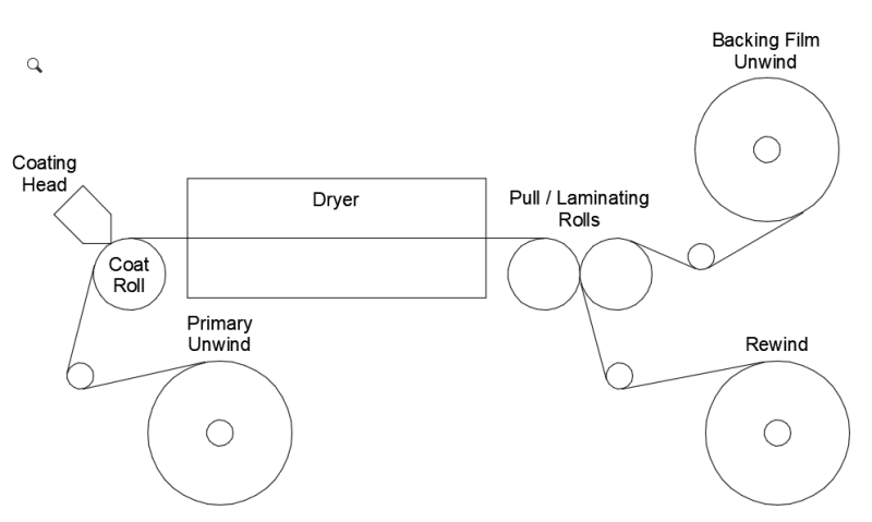

I have an application in which I will be driving an 8" diameter roll that will be supported on each side by steel frames with fixed position precision bearings. I will be using a VFD to drive an AC motor with a 60:1 gearbox and an additional 2:1 belt/pulley reduction. Other than having to turn the roll itself at a constant speed, there is no additional load. From past experience, I feel pretty confident that a 1/2 HP motor will be able to do this job.
I'd like to know what calculations I can do based on the information above (and any other information I can request from the motor, gearbox, roll, and bearing manufacturers) that would allow me to determine with a higher level of confidence whether the 1/2 HP motor I have in mind will in fact work for this application.
Any advice will be greatly appreciated. Thanks in advance.
Paul

Hi Bill, Keith, CompositePro, and Muthu,
Thank you for your continued support. The suggestions of using a clutch or other "loose" or "slippy" drive mechanism makes total sense to me if given my 60:1 gearbox reduction and my roll diameter, I was running the motor at a speed that (without slipping) resulted in the roll surface speed being faster than my web speed. This is not the case (and I apologize for not adequately explaining my application). As I believe Keith and Compositepro alluded to, if I insist on using the gearbox, I would have to implement a drive system with some type of closed-loop, master/follower, electronic gearing type speed controls. I believe this is exactly what I am doing. I will try to explain using my original illustration, which I have pasted again below...
...I actually have two separate drive systems with closed-loop speed controls, one for the Pull/Laminating Rolls and one for the Coat Roll. As it is the Pull/Laminating Rolls that determine web speed, I configure the Pull/Laminating Roll Drive System as the "Master" Drive. The Pull/Laminating Roll Drive System consists of a DC motor fitted with a 60 PPR ring-kit along with a DC regenerative drive board and a closed-loop speed controller. The speed controller allows operators to enter a speed set point in feet/minute. Internally, the speed controller does some scaling using roll diameter, gear reduction, and ring-kit PPR to relate ft/min to motor RPM, but the end result is that it controls motor RPM so that the actual roll surface speed will equal the entered set-point. As long as the gap between the two Pull/Laminating Rolls is set properly so that there is no web slippage, this ensures that my web speed will be the same as the entered speed set point.
Just like the Pull/Laminating Roll Drive System, the Coat Roll Drive System consists of a DC motor fitted with a 60 PPR ring-kit along with a DC regenerative drive board and a closed-loop speed controller. The only difference is that I configure the Coat Roll Drive System as a "Follower" Drive. In this configuration, the Coat Roll speed controller allows the operators to enter a speed set point as a ratio of the Pull/Laminating Roll speed. Typically this is always 1:1 because while the Pull/Laminating Rolls actually determine web speed, we just want to match the surface speed of the Coat Roll to the web speed so as not to create drag. (Sometimes we might adjust this to 0.999:1 or 1.001:1 just to compensate for any stretching or shrinking that might happen in the dryer). Internally, the Coat Roll speed controller monitors the feedback not only from the Coat Roll motor, but also the master feedback from the Pull/Laminating Roll motor, and (doing the necessary scaling), controls Coat Roll motor RPM to achieve the desired speed match.
Anyway, this control scheme works fine. I have absolutely no problem getting the speeds to match using this type of drive system with gearboxes. I have gotten this to work many times with different gearbox ratios, sometimes with an additional belt/pulley reduction in addition to the gearbox reduction. I choose my gearbox and belt-pulley reduction based on the particular customer's required speed range.
The reason I originally posted this question is because I strongly suspect that I routinely over-size the motors I use because I do not know how to calculate required motor horsepower based on what I am asking the motors to do.
Just to complete the description of my application, Muthu touched on the fact that this application sounds similar to a cassette recorder where the tape has to travel at a constant speed, but the Unwind and Rewind spools have to vary in speed as diameter changes. I think this is a good analogy. While the Pull/Laminating Roll Drive (assisted slightly by the Coat Roll Drive) handles my speed control function, I implement tension control (rather than speed control) for my Unwind and Rewind Shafts as described below.
For unwind tension, I mount an electro-magnetic brake on the Unwind Shaft and I have a tension sensing roll (not shown in my illustration) in the Unwind Web path. I use a closed-loop tension controller to monitor the feedback from the tension sensing roll and to regulate the brake voltage (allowing it to slip) as necessary to keep tension at set point while web speed remains constant.
Similarly, for rewind tension, I mount an electro-magnetic clutch on the Rewind Shaft and I have a tension sensing roll (not shown in my illustration) in the Rewind Web path. I drive the input to the clutch slightly faster than what would be necessary to keep up with web speed at minimum spool diameter). Then I use a closed loop tension controller to monitor the feedback from the tension sensing roll and to regulate the clutch voltage (allowing it to slip) as necessary to keep tension at setpoint while web speed remains constant.
Again, this all has worked fine for me for quite some time. I would just like to become better able to estimate my motor HP requirements to (hopefully) avoid over-sizing as I am sure I have done in the past.
As I mentioned, for the project that sparked my question, I have already ordered the 1/2 HP motor and 60:1 gearbox for the Coat Roll, and it seems like I could have gotten away with something smaller. The project that requires this Coat Roll only includes an add-on coating station for an existing machine (built by others). The information I have provided about the Pull/Laminating Rolls and Rewind are based on what I consider typical for the machines we build. In this case, my Pull Roll motor (with a 60:1) gearbox would be directly driving the (chrome-plated) Pull/Laminating roll on the left, and indirectly driving (by surface contact) the (silicone covered) Pull/Laminating Roll on the right. It would also be pulling the two films (one from the Primary Unwind and one from the Backing Film Unwind). In some cases, I use the same motor to also drive the Rewind Shaft (with electro-magnetic clutch). Based on past experience, I would be totally confident that a 1-1/2 HP motor would be more than capable of this task, and I would be reasonably confident that 1 HP would also be fine. While I expect I might be able to go even smaller, not knowing how to do the necessary calculations would make me hesitant to try.
It seems to me that there must be a way that I can calculate a rough estimate of my required motor HP in an application like this. I have a feeling that using the weight of my rolls, my tension ranges, my diameter ranges, and possibly other factors, I should be able to calculate my torque requirement for the driven roll. What is unclear to me is considering that I will be using a gearbox, how do I relate my torque requirement for the driven roll to a HP requirement for my motor.

The reason I am still interested in learning how to do these calculations is because I am rarely fortunate enough to get to repeat a proven design over and over again. All of the equipment we design/build performs basically the same function (roll-to-roll coating), but it is all custom and the specific requirements for every project is different.
Our "most standard" machine has an eight inch diameter (16 inch wide) Coat Roll and 8 inch diameter (16 inch wide) Pull/Laminating Rolls, with two 3 inch diameter rewind Air Shafts capable of winding spools up to 20 inch diameter. As we have built this a few times, I know that a 1 HP motor (w/ 60:1 gearbox) for the Coat Roll, a 1-1/2 HP motor (w/ 60:1 gearbox) for the Pull/Laminating Rolls, and a 1-1/2 HP motor to drive both rewinds (using electro-magnetic clutches) works fine. Even though I feel like my motors might have more horsepower than I truly need, I would not change this if I am fortunate enough to have an opportunity to build this machine again.
Quite often, however, we take on projects that are quite different than our standard machine. Currently, we are beginning our design phase for a very small machine which would have just a single drive. My Pull Rolls (no laminating function on this one) will be 3 inch diameter and 12 inches wide. My single Rewind will only have to handle spools from 6 - 10" diameter. Where as with the "standard" machine I mentioned above I used three separate motors/drives, for this small machine, I hope to use the same motor/drive for the Rewind that I will use for the Pull Rolls. On this machine, there will not be a driven Coat Roll. This will be a 2020 version of a machine that was built by others in 1990 (just two inches wider). The 1990 machine drives uses a 1/8 HP motor, so I am leaning towards 1/4 HP just to be on the safe side considering the extra 2 inches of width. While I feel comfortable in making this decision, I still wish I knew how to back it up with some calculations.
Another project I am working on at the moment is to add a dedicated motor/drive to handle two Rewind Shafts on an existing machine. These rewind shafts currently share the motor/drive that handles the Pull/Laminating Rolls, but a new process requirement will make it necessary for the Rewinds to have an independent drive. In this case, space on the existing machine is very limited. For this reason, it will be to my advantage to use as (physically) small a motor/gearbox that I can comfortably get away with.
For reasons like this, I really want to make an effort to get an understanding of how to (mathematically rather than gut feeling) estimate my required HP in various circumstances. I will always try to err on the side of caution (over-sizing), but I feel making this effort will be well worth my while, even if for no reason other than trying to get a better understanding of the systems/equipment I work with.
You guys have all been so helpful. If you don't mind, I may try to get started on some calculations for the project on which I will be adding a rewind drive and post them here to see if you think I am on the right track.

I guess none of us who have replied have answered your your basic question of how you calculate required horsepower. This is because the answer is so basic to engineers that we assumed you were interested in more subtle details. Horsepower is a unit of power. Power is the rate at which energy is consumed. Energy is force times distance, ft-lb (ft. traveled x pounds force pushing). Do not get confused by the fact that torque has apparently the same units of lb-ft (pounds force twisting x ft. of lever arm).
For your application hp is torque (required to turn your roll) x angular speed (rpm). Get a basic physics book and the first chapter on mechanics will explain this. You can also find tutorial on the internet like those at Khan Academy.
To further Comp's statement we're not really answering your fundamental question because it's not a mathematically straight forward calculation. Answering the question of, "how much horsepower does it take to turn this roller" has many possibilities of answers based on more specific details.
1) Are you seeking steady state hp?
The bearings are all that matters in your case.
2) The hp to accelerate the roller up to what speed?
When you accelerate the roller you are storing energy in it that once speed is achieved no longer demands further energy input. But your app likely requires no real acceleration.
3) How fast to that speed? This increases the torque demanded.
The faster you want to get the roller to speed the more torque demanded. More torque can be achieved most simply by a bigger motor. However it can also be achieved with a gear reduction.
4) Drive train efficiency is never 100%. One set of gears is at least a 3 percent loss. Belts have losses too. So this muddies the water further.
5) Then you have the load contribution of the material across the roller. Is the roller contributing to driving the material? If it is, that number for the drag is critical to the answer. No math is going to provide that number for you! It has to be empirically measured.
Your particular situation is not amenable to "calculation" because the variability of the needed hp/torque calculation is completely swamped by the motion system itself as compared to the actual work needed to be done.
As an example, a sand conveyor is relatively easy to calculate. You can pile W amount of weight on a foot of conveyor belt. The conveyor belt is d long. The belt weight can also be calculated though it could be a wash due to the returning belt paying back with gravity. You then have the angle of the belt which provides the height the sand is being hoisted. These few facts directly gives the fundamental hp required to do the job.
The designers then find the drag of the rollers (probably from a book, rule of thumb, or a belt provider) which they add into the hp requirement. When done they multiply in a safety factor of perhaps 1.3 to cover any unexpected drag.
In your very different case you're turning the roller so slowly that acceleration, inertia, and bearing drag are all essentially nothing or are so fleeting as to be completely inconsequential. By far the largest consumer of hp in your case is the gearbox/belts aspect followed by the fan on the motor. The material across the roller is not even a load.
So, asking how to calculate the hp requirements in your application is.. incalculable. Instead it would normally be done one of three ways.
1) You'd assemble the roller and load up the machine and pull the web with a spring scale to get the work needed to be done. Then you'd double that and work back to the motor size.
Or
2) You'd work from experience having a feel for the size needed.
or
3) You'd go with the smallest size normally found in the industry.
Note that none of these embraces "calculations".
Hence, you see why we aren't showing you a way do it. We ourselves wouldn't be bothering.
