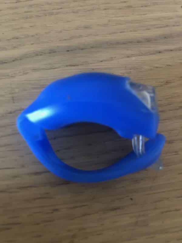

Hello! I am trying to calculate the clamp force of an elastic band around a handle bar. I want to prove it can hold the weight of a phone mount. I know I need to be able to resist the moment force and gravity at the worse load cases, but am having trouble figuring out how to do that. Do I need to estimate how much the band will stretch, then I can figure out how much pressure it getting put on the handle bar which can relate to a normal force? Any tips would be highly appreciative. I attached a photo of what the design would look like.

Thanks for the tip on the image upload, I think I got it.
I guess I'm wondering how do I show the free body diagram of the latch can withstand the weight of the phone?
Since you already seem to have a prototype, just do some tests.
Given the many already existing phone holders for bicycles available there doesn't seem to be much risk here.
The picture is just an example of how the design would work. I am interested in the math to prove it.
