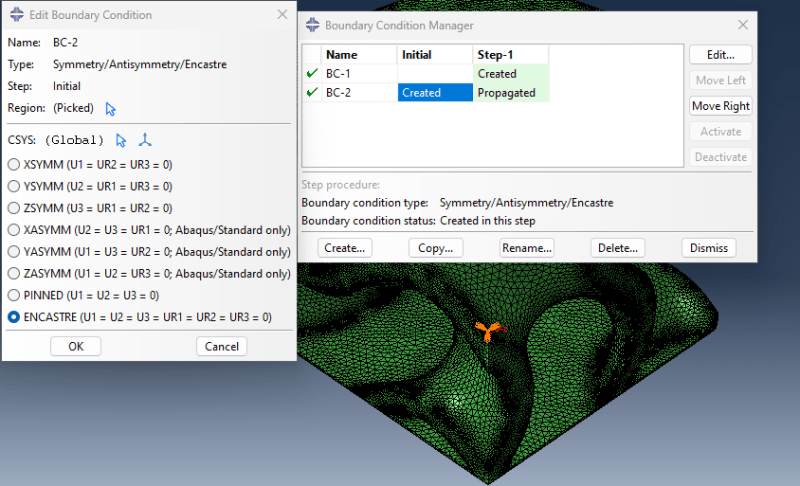

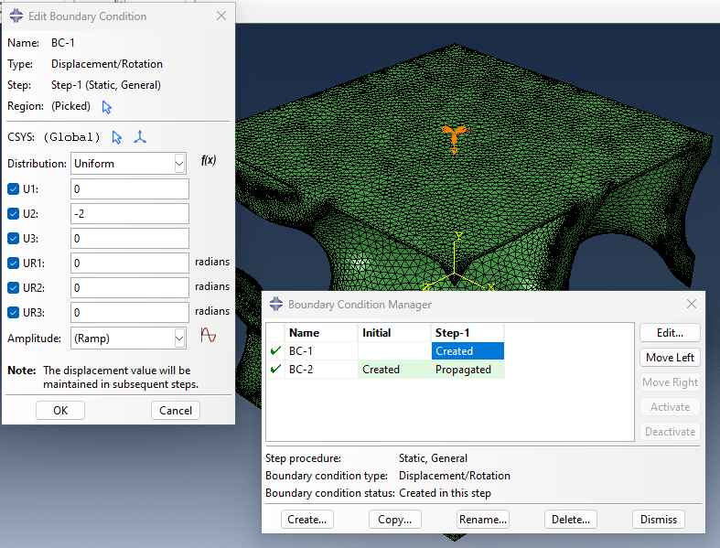

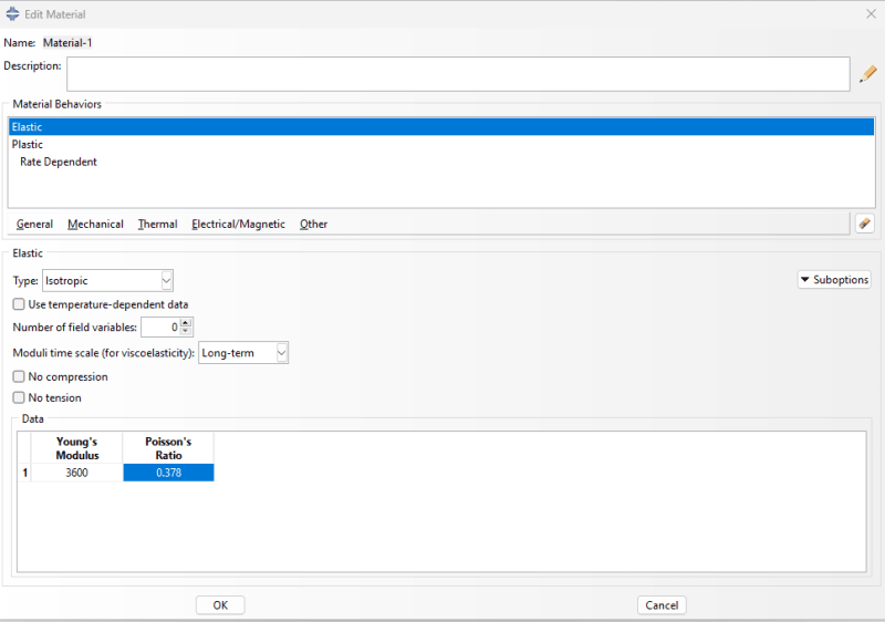

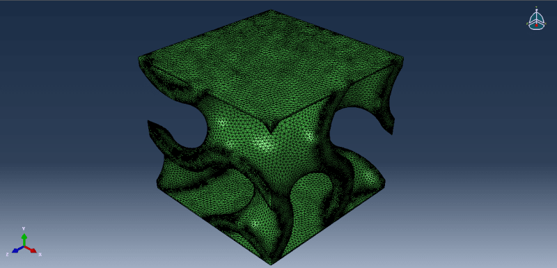

Hello,
I am simulating a compression test on a gyroid lattice structure in abaqus cae. The geometry has solid surfaces on top and bottom and in between there is a gyroid lattice structure. The model is 10 mm in LXBXH.I applied a displacement of 2 mm on the top surface and fixed the bottom plate with encastre to replicate similar conditions to experimental compression testing. I have given material property only in the elastic region with E= 3.5 GPa and v= 0.378. The mesh size is 0.12 mm. The simulation runs and completes. Can anyone help me in how I can find the values of Young's Modulus or Stiffness of this structure?

Geometry is in mm, E is in MPa v is unitless. displacement in mm.
please post a picture of your model (embedded not linked).

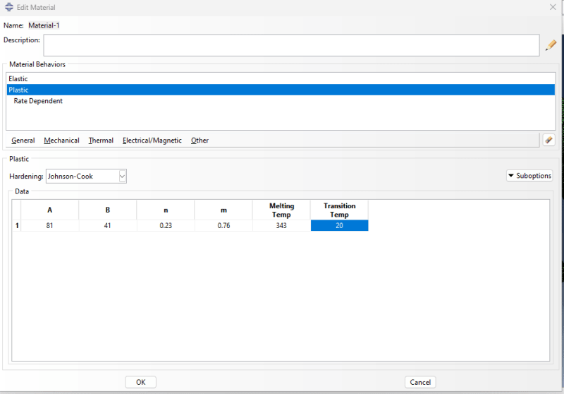

Here are the images
@SWcomposites thank you for your suggestion. I have a few questions regarding it. What will be the cross section area with respect to my geometry. I am applying a fixed displacement so that I get convergence as when I applied pressure to the top surface it was not converging.
In which plane would the cross section for area calculation be. ALso would it work if I calculate the Reaction Force 2 at the last increment on RP1 and divide by the area of the top surface to calculate stress and Displacement at RP1 and divide by the total height of the lattice to get strain. and then divide the 2 to get the answer?
