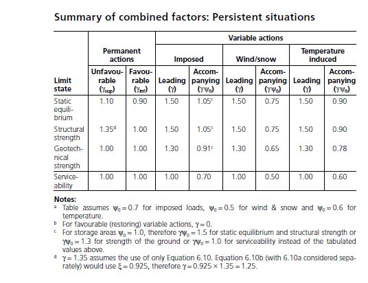

So, you mean I can just combine the lateral and vertical loads together in the EQU equation? So it would add the wind load as either leading or accompanying variable as follows?
example combination 1: (1.5 x Self weight) + (1.5 x wind load) + (1.5 x concentrated load 1) + (1.5 x 0.7 x concentrated load 2)
example combination 2: (1.5 x Self weight) + (1.5 x concentrated load 1) + (1.5 x concentrated load 2) + (1.5 x 0.7 x wind load)

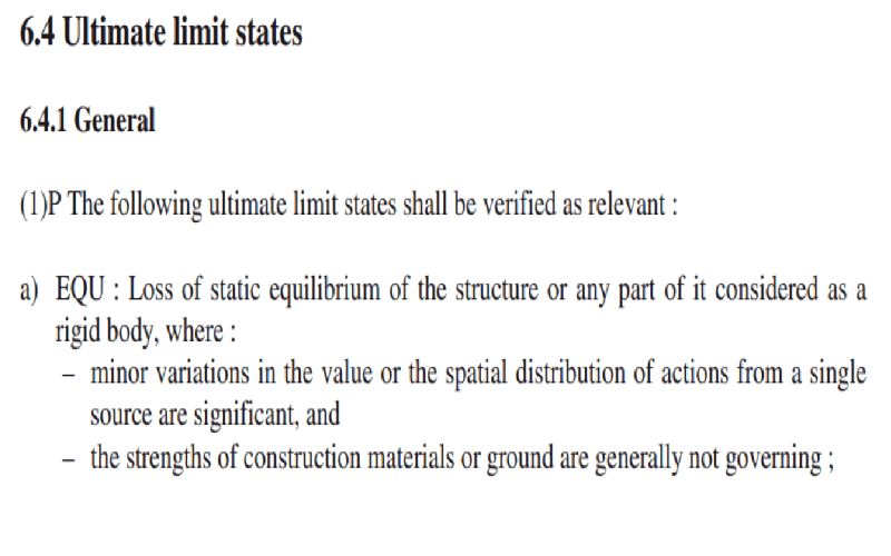

You basically created another confusion in my mind (in a good way). So if I wanna check for EQU, I need to put all the loads of 'entire multi-story building' into that one equation than just checking the beam individually? that means that one single equation would have like 100000 different loads (for entire multi-story building), and that equation would be long like the distance from earth to moon? and How many combinations that could have? gazzilion of combinations? or is there any other way to check EQU? How did the Engineers before ETabs or STAAD did it? What's the method in real-life situations.
You are not "checking the beam" with EQU, but rather checking that the entire structure does not topple due to overturning. Alternatively, if the entire structure is just a beam (e.g., overhang beam), you use EQU to check if uplift occurs at supports.
If the contact between structure and ground is fully in tension, you have a global stability failure and failure of EQU criteria. Think of a gravity retaining wall overturning check.

You are looking for the load combinations to check for EQU. wright?
EQU is one of the Ultimate limit state is for checking the Loss of static equilibrium of the structure overturning,sliding, uplift ) or any part of it considered as a rigid body,or any part where the strength of construction materials or the ground is generally does not govern.
Assuming the subject beam is an element of a frame , the EQU combinations for the overall structure in this case ,
Ed1= 0.90 Gk,j + 1.5 Qk (wind) + 0.0* Qk (Imposed LL) FOR overturning,sliding, uplift..
Does this respond answers to your question? If not, provide a sketch of the total structure together with applicable loads..
