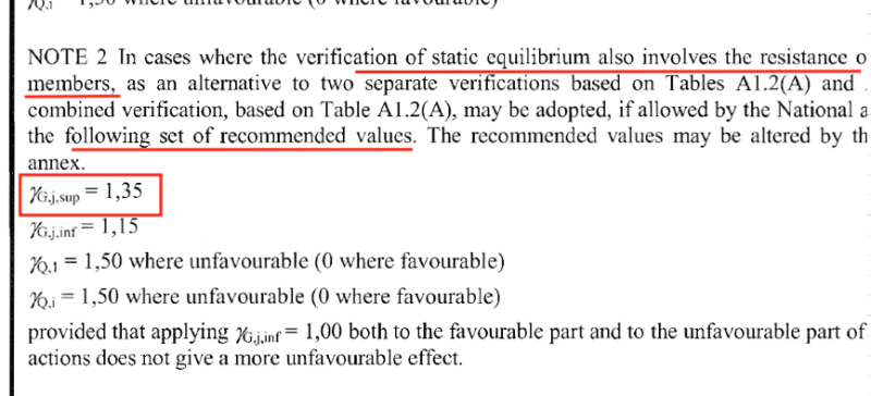

I was checking the load combinations and then was trying to check for EQU. (Trying to learn how to do it in real-life situation)
My aim was to find out the loads acting on the beam and find the forces. Feed the forces into EQU equation stated below. Then feed the forces into bending moment equations to design the r/f needed etc.
The equation is from: clause 6.4.3.2, page 47, Eurocode 0.
I did the calculation to find the loads as below, but I don't know where to place the wind load in the equation as it's lateral load. I don't even know if the above equilibrium equation is supposed to have wind loads as well.
combination 1: (Self weight) + (1.5 x PL1) + (1.5 x 0.7 x PL2) + WIND LOAD
Ed = (1.35 x (2 kN/m x 6)) + (1.5 x 15 kN) + (1.5 x 0.7 x 20 kN) + WIND LOAD
Ed = 16.2 kN + 22.5 kN + 21 kN + WIND LOAD
Ed = 61.95 kN + WIND LOAD
Then I calculated total moments, but since I don't know where to put "wind load" in above equation, I didn't include it.

1. Why did you used 0.90 for GK as we're trying to find out both EQU and overall STR. The Gk,j should be 1.35 isn't it?
2. The self-weight should be "favourable (supportive)" for the building as it resists the overturning from wind isn't it? so the fact that you used 0.90 doesn't make sense to me.

A= NO !!!! Dead load (Gk) is favorable in this case . and the coeff. shall be 0.9 ..
A= It makes sense ..Consider a frame will be checked for EQUILIBRIUM , say for overturning. The resisting moment to overturning shall be calculated with min. dead load and zero imposed load . While the destabilizing load due to wind the coeff. for wind shall be 1.50 ( if leading action)
static equilibrium may be expressed as follows:
Ed,dst < Ed,stb
In this case ( checking for overturning due to wind ) the design effects of destabilising actions (Ed,dst= factored OT moment due to wind )shall be less than the design effects of the stabilising actions (Ed,stb= resisting moment due to minimum dead load ).
Literally this means , minimum overturning F.S.= 1.5/0.9=1.67 ( when we do not consider the lever arm effect)..
Yeah I understand it's favourable here and should use a lower value for dead load as well, however, I noticed a second set of factors should be used because we're checking for both EQU and STR? The following A1.2(A) mentions we can use "1.35" for favourable dead loads. Isn't that correct?
