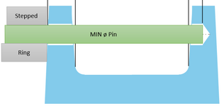

Yes. Actually nothing is being "measured" now. To check dim 18: the current method uses gauge fixtures & pins to simulate the maximum size of dim 18 mating part. This gives a AC/NC result.
To check depth of pin, a MIN ø pin (longer than dim 25 is inserted and it will protrude from left side hole. This protrusion is judged by a stepped ring fitted onto it, which gives a AC/NC result.

A picture of the setup is worth 1000 words.

Sorry for my laziness :D, refer below for measurement setup.
This checks Go & No go (i.e. pin height must be within the step).
This only checks Go.
Stepped ring looks something like this (copied from internet): 1743136583218.png
Why is the measurement from a surface that doesn't control the depth of the pin?
Since the minimum remaining wall is what is important, then dimension the remaining wall thickness with a stub pin.
Stepped ring looks something like this (copied from internet): View attachment 7316
This the best method. I would suggest to make the drill point optional with flat bottom, using a center cut end mill. then a standard drop indicator with extended tip would be the fastest
