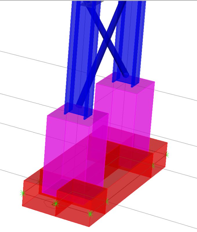

Well actually the problem arised from the fact that I petulantly insited on modeling the r.c. foundation+ r.c. column pedestal + steel super structure as whole not spliting them to foundation + superstructure and analyse them sepereately. I have my own reasons, in our codes seperating structures imposes you to use factored loads on foundations and I was planing to avoid that, furthermore it will be built in seismic zone + I thought that it will be more accurate and economic in that way of modeling.
As you all pointed, modeling steel columns as pinned at the bottom eliminates that moments, @jayrod12 there doesn't seems to be any problem this time at the upper structure, what you said was totally I was worrying about (after pining column at the bottom I was expecting that will to contribute negatively to the upper structure as upsizing, cause overall stiffness of structure needs to be stabilized one way or the other). and was grudging to implement it, but this time it didn't cause problem bcoz I slightly overdesigned some of the sections i think, but I'm precautious.
View from steel column in question which receives high moments.

JoeH78 said:
I don't see how your columns bases could have EVER seen those moment with that foundation. I'd expect that you have applied excessive rigidity in modelling that foundation. It would rotate well before any decent hold down bolts start having issues.
