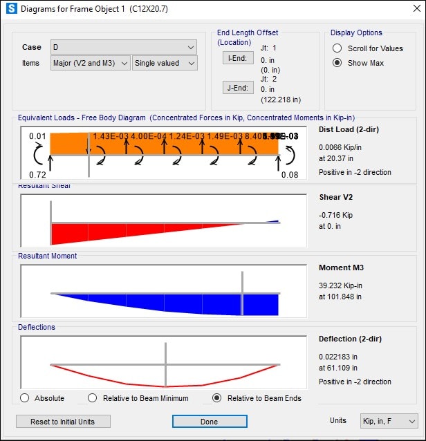

So when I run analysis, I can see the deflection in any particular beam, is their a way to export this? I can export the moment and shear force diagrams, but not the deformation shape diagram.
Unfortunately, there is no easy way to do this. About the best you can do is display the shear or bending moment diagram (F8), right-click on the member under consideration. That'll give the following:
