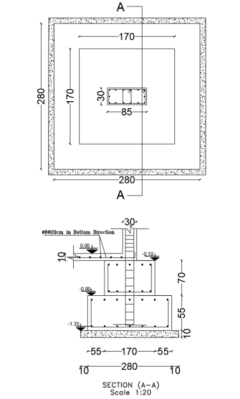

Hello everyone, I have a Footing that was poured at 55 cm thickness, 15 cm lower than required (70 cm), punching shear failure will occur, How is it possible to increase the thickness of the footing?
note that the footing was poured recently, and no work has been done on the column necks

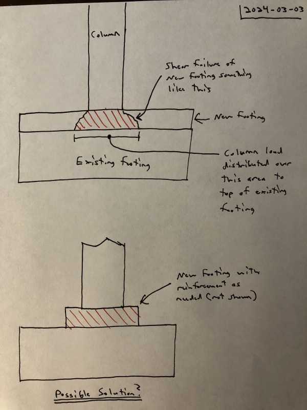

is it possible to add a footing on top of the existing one, which will do its job to overcome one-way and two-way shear failure, while the existing footing will transfer the load to the soil safely?
That looks like it would work.
If you have that much space then why not get the contractors to scabble the surface, epoxy some bars in, and pour a block the same width as the whole foundation below?

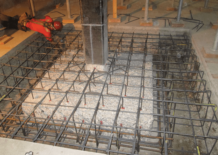

I've done your scab solution. In my case, we were adding load to an existing foundation (about +10%). The existing footing was an 8ft wide continuous "grade beam" footing. We drilled vertical bars into the top of the existing footing, and added an 8ft square "scab" on top to justify engaging a larger area of the existing grade beam. Checked vertical shear at the critical sections and checked the interface for horizontal shear (VQ / It) in the vertical dowels.
The shear wasn't that hard. The trickier part was how to get the load from the column into the top "scab". In your case, I take it the column hasn't been poured yet? So you may not have an issue there.
If it's not too big a footprint put vertical dowels in spaced as shear reinforcement and put a capping thickness on top. This is similar to one of the ways you do post installed shear reinforcement for seismic design in beams or slabs.
Footing on top of a footing that some people have proposed is fine too, but looks a bit wonkier.

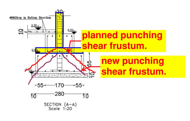

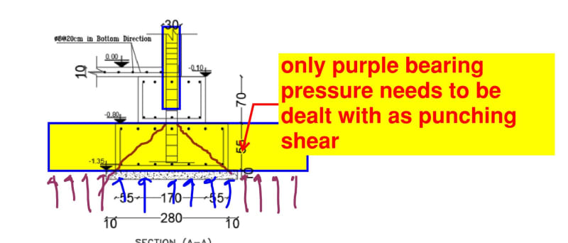

I'm not sure that there's actually anything here in need of fixing. It appears to me that your original punching shear frustum wouldn't have even been contained within the original footing. Looking at the proportions involved, I don't see punching shear being a legitimate failure mode for either the original design or modified condition present in the field.
If this thing even needs flexural rebar, it's basically just a strut and tie situation for an elephant's foot / pedestal element.
Ugh... I see now that OP's sketch was not to scale.
Depending on how the original design was performed, this might represent another path to "do nothing".
Further into the thread I think it's clarified that this is a one way shear problem. That being said, the code one way shear provisions are conservative for this type of deep beam situation with a short span. If it's failing out of the near field zone there are a couple of ways to take advantage of that conservative situation. One is a strut and tie model. The Canadian concrete handbook has this exact situation demonstrated in the examples, with a deep footing failing with the code provisions and then an example strut and tie model passing it.
