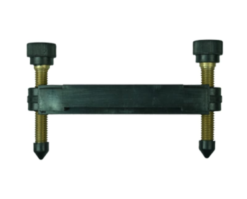

Anyone have the schematics for the screws that are in your second image ( or in the surveyors transit as suggested by hydtools? Maybe that will help. But still need to ensure everything is fastened together tight with no give.

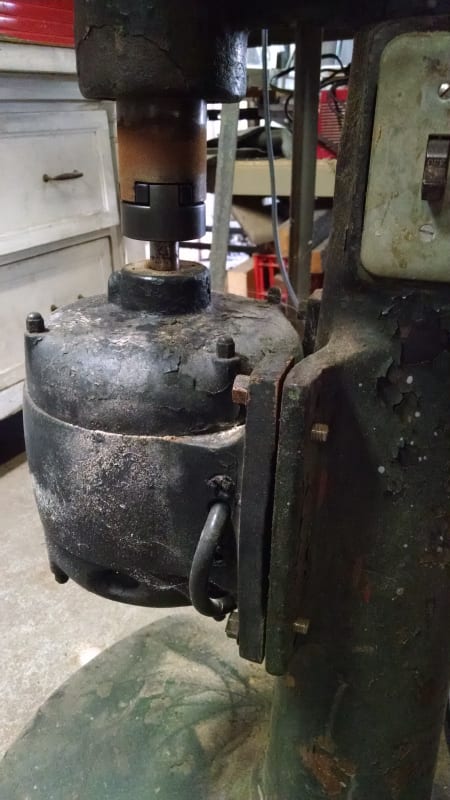

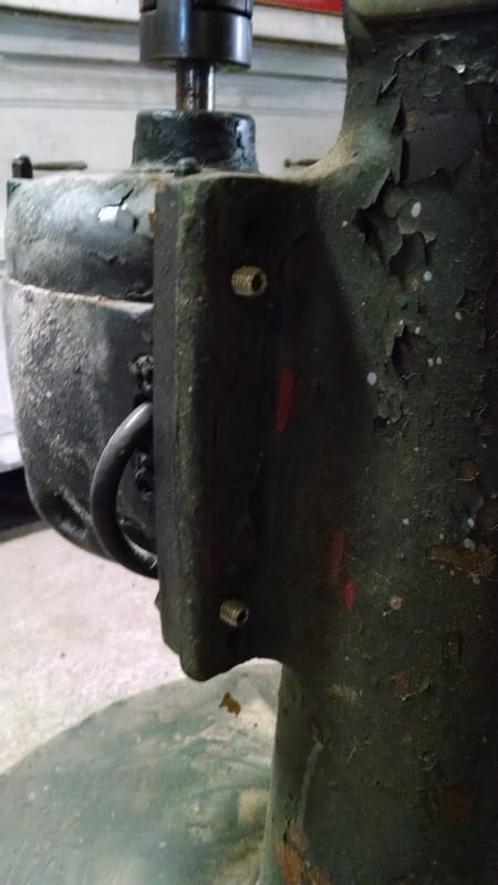

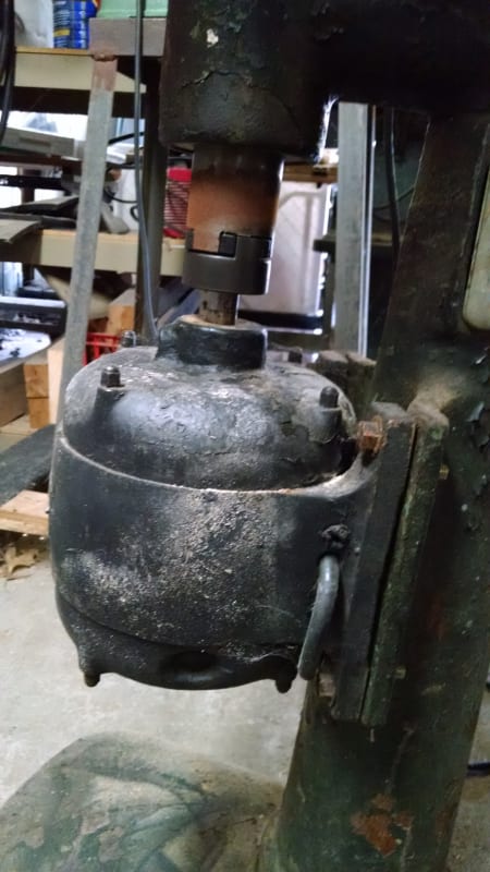

I found these photos from one of my old woodworking tool.
The motor is aligned to the shaft coupling by tightening and loosening the bolts and set screws.
