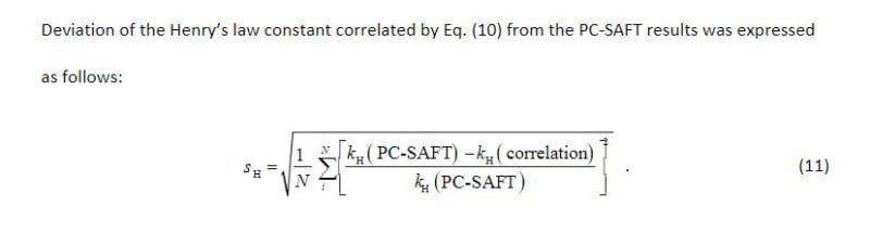

As to N2 solubility, I've found the following reference for the Henry's Law parameter as being 0.0013 for N2 in R134a (Table 3).
Solubility of nitrogen in one-component refrigerants: Prediction by PC-SAFT EoS and a correlation of Henry’s law constants November 2011International Journal of Refrigeration 34(8):2109-2117

Good find, but that's not Henry's Law parameters. It's a standard deviation of Henry's Law parameters between an EOS and a correlation.
I don't think that article lists any Henry's Law parameters; not of R134a anyway. It does give parameters to an equation that allows one to calculate R134a's Henry's Law parameters.
