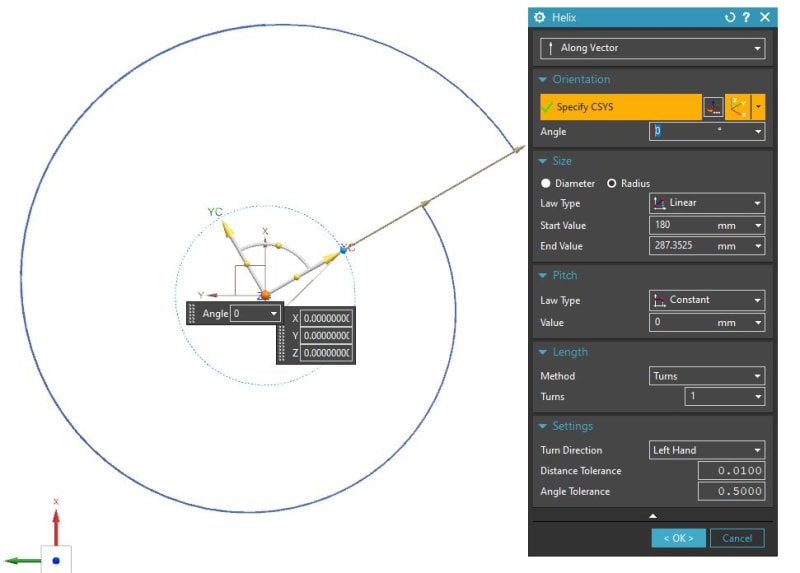

I want to draw a spiral according to the dimensions on the image, but I can't find a way to make it.
Key dimensions:
- The start point should be at 30° with a start radius of 180mm.
- Spiral has 1 revolution (360°)
- (This is the hard one) The maximum height point (where the tangent is horizontal) needs to be at 270 mm from the X axis (notice that this point is not aligned with the Y axis)
I tried law curves and helix, but I can't, for the life of me, find a way to get the "270 mm" maximum height correct.
Hey,
It's not math method, but for single case is quick.
Try with this parameters:
The value of 270 dimension is 270.0001.
If You need higer tolerance, try change 287.3525 value.
Best regards
MANok
The optimization command can make this an easy task. I drew a spiral like MANox (180 start radius and I guessed with 300 as the end radius), then created a sketch (a single horizontal line tangent to the spiral), finally I created an associative measurement from the center of the spiral to the tangent line. I started the optimization command and told it I wanted the measurement target value to be 270mm and the variable was the end radius of the spiral. It converged to a solution very quickly.
