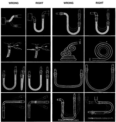

Good afternoon, I would like someone to help me with the following situation. I am modeling a piping system in CAESAR where the connections to the equipment are made with flexible hoses (a tight corrugated stainless steel tube with or without braided stainless steel mesh suitable for operating within a wide range of temperatures and pressures, capable of compensating for a variety of movements with excellent anti-corrosive properties. They are of annular type and manufactured according to ISO 10380 standard and their end fittings according to ISO 10806 standard).
What would be the best way to model this in CAESAR? Typically, where I work, they don't usually do it assuming that the flexible does not load the connection, so the model ends at the flexible connection flange instead of ending at the equipment connection. However, here is the detail of how I model that connection to be as realistic as possible. I was thinking of modeling it as an expansion joint and inputting the axial and transverse stiffness coefficients without adding the effective diameter, but the flexible supplier tells me they do not have the stiffness coefficients as they are very low and considered negligible, loading very little. What do you recommend I do?
"Attached are images of the flexible hoses. There are hoses for cryogenic service that are vacuum insulated, and others for gas, drains, and lubricating oil that are basically the same."

Listen harder to what the guys at work are telling you.
First, you probably won't get full stiffness values for the hoses from the manufacturer, at least I've never been able to get any when asked by clients.
Second, yes, the hose does have some theoretical stiffness similar to engineered expansion joints. However it will be such a low value compared to rigid piping, nozzles, and/or other devices that it won't matter.
More importantly is that the hose is installed properly. See the install guide at the back of any hose catalog - typically I end my model at the inlet of the hose and use the Caesar II output to determine the movements and size the loop/hose properly.
And BTW don't tell your client how you are burning through the engineering budget.
I would just model it as a free end tbh.
The thing you need to check is the movement, especially axial as hose hate being stretched or compressed or bent outside their accepted radius.

A flexible pipe has very little strength or resistance to movement, but as noted above, needs to be used in such a way that you don't end up stretching it or inducing buckling or tight radius.
jgilrod
Your piping system termination at the flex hose would have to be properly supported and restrained to meet the movement allowance at the flex joint. You can't model a flex joint properly of any use.
