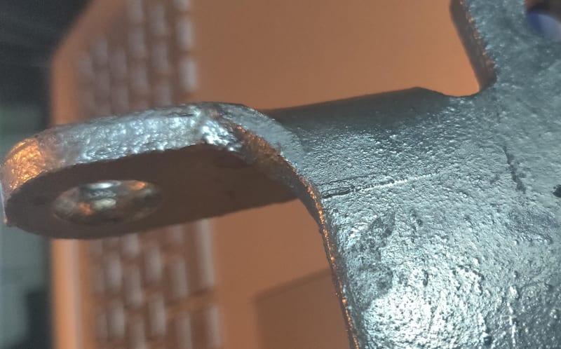

I need to model this bend (circled red in attachment) properly in Solidworks but am unable to figure out how to do so using the sheet metal tools. I don't really think it's possible to get what i need using basic extrude / cut tools either. Anyone want to take a stab at it or point me to some tutorials?? I can imagine the flat pattern but then the two tabs are somewhat twisted while bent which i am not able to achieve. It's a tricky one...

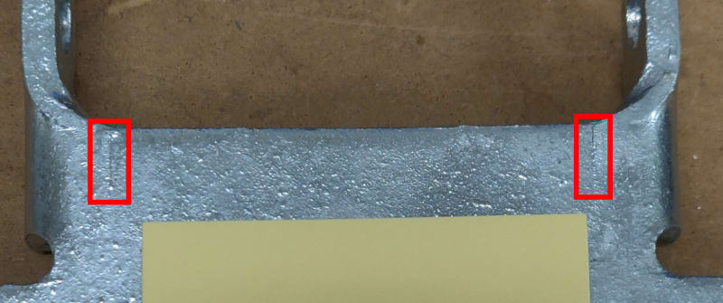

The object in the picture is a welded construction, not bent.
It looks like it had relief here and then was welded and ground flat. Other than those areas it looks like it is a true bend.

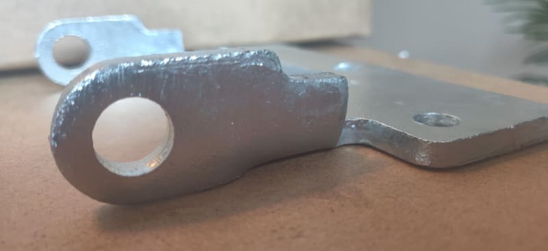

Looks to me like it's stamped in a progressive die. It's not purely sheet metal because the die does more forming than just bending.
Thanks for the responses everyone.

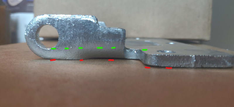

Sbaugh, it does look like it could be welded when looking at the pics I posted previously, but in hand it is clear those marks are tooling marks. This pic might be a little better.
I think Handleman has it, the die is definitely doing more than just bending. The material is deformed a bit and twisted to get the geometry. The edge of the hole near the bend is tangent to the top surface of the flat plate (green dashed lines). The bottom of the tabs are collinear with the bottom of the plate (red dashed lines).
I think using the flex feature is the only way to truly get the geometry I need, but i think i can get close enough w/ sheet metal tools, some other features, and having a discussion w/ the supplier. I don't think I can work this geometry out of the design unfortunately.

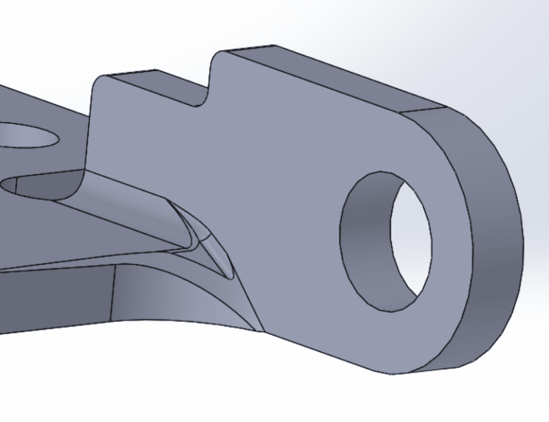

Here's a few pics of the model where it is now. Not perfect but I think it'll end up working.
