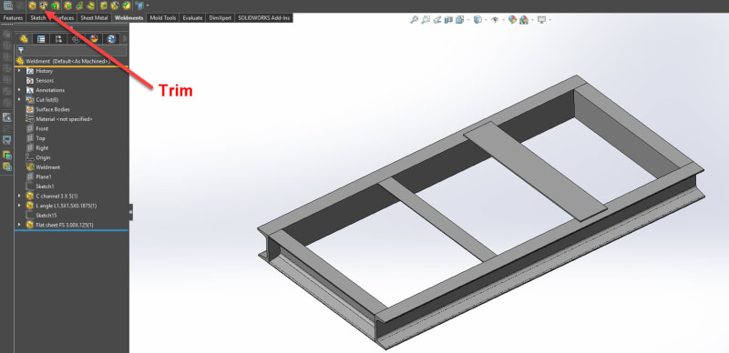

hi guys, I have a structural C channel rectangular base with 2 strips of angle iron going through the middle of the C channel base. Then I have a 1" square tubing that is placed on top of the Angle iron. I want to send this out to a machinist so I can get it built but not sure how to go about the Shop/machine drawings so they have the proper dimensions laid out.
Ill be sending my machinist the 3D cad model of the base and will start to work on the shop drawings for the base as well but I am getting different responses on how detailed I need to be with the shop drawings.
Here is an attached picture below of what the base looks like. How would you go about giving the proper dimensions for this when sending it to a machinist to build? All are standard metal parts.

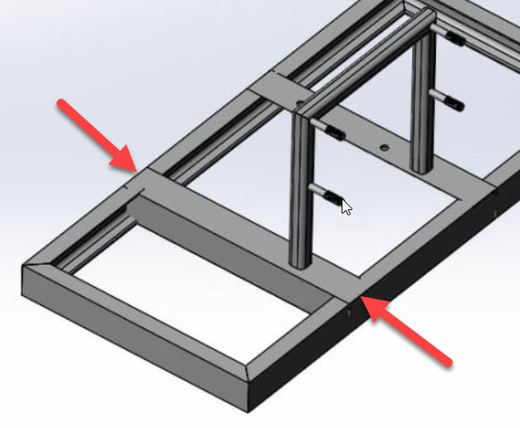

I would flip the outside frame around and use the flat side of the steel to work with. Coping the cross members to fit the inside of the is going to suck and be expensive. Attached is a frame I made for one of our generator bases late last year.

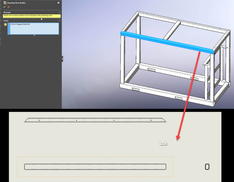

If you made this as a weldment part you can make the first sheet your weldment cutlist and the location\welding symbols sheet. Then on the next sheet, you select which bodies you want to see and make a drawing of all the individual bodies and include them all in one drawing.
For Example:
I hope this helps,

Your frame is simple enough that a competent shop should be able to weld it up from three views, outside dimensions, and material size notes. Probably no need to go detailing every cut piece with its own views.

The dimensions of the bottom base is 32" by 15". The angle iron that is going into the C channel where you mentioned it should be cleaned up I am not sure if I should actually the the angle iron at the end to the exact spec profile of the C channel is? I use solid works and wasn't sure how to actually clean that part up.
I would not make your frame like that, whether you did it in SW as a weldment or not. If you did not make it as a weldment you're going to have to convert the edge from the other component (plus welding gap) to trim it. If you did make it as a weldment you can use the trim tool.
Attached is how I would make your design and it looks a lot cleaner and it's easier to build, plus it's FAR less expensive. If you want to waste money I will be happy to take some off your hands.[roll1]
Honestly, I probably wouldn't even use C channel because it's just too expensive anyway. A piece of u bent steel would be sufficient. Varying on how much weight you plan on putting on it would vary the thickness. Everything I make here is usually .1875 to .250 thick because I have over 1500+lbs pushing down on it. I would venture to say I could go a little less thick, but when in doubt make it thicker [flip].
The attached file is in 2018.
