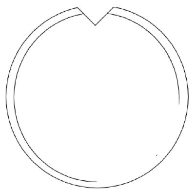

Hi Lafuite,
Sorry, I (we ) do not understand "With a triangular file or a machine tool make a groove parallel to the axis at 60 °. Then with a small diameter wire (taken from an electric cable and measured) and a nut you can control the passage section." We would be really appreciate if you can explain so we understand.
But, we did a test: M9, thread 1 mm (fine metric), screwed in a block, for about 10mm. The opening, more or less a triangle/circle segment (between the top of the rod thread and the deepest point of the bold) would have about 0,02mm² . Just a figure because hardly to estimate due to tolerances. In fact we formed a spiral pipeline of about 30 cm.(+ presumably some parallel leaks)
300 ml starting at 380 bar, gave us ca 5 min... So when going to and M4, and longer ...?
So we are looking forward to your "... make a groove parallel to the axis at 60 °. Then with a small diameter wire (taken from an electric cable and measured) and a nut you can control the passage section."...
Thanks in advance.
Hello,
A sketch of the machined groove. If there are 10 threads this makes 10 nozzles in series. We consider the zero flow in the helicoid of the thread.
Hi Lafuite,
Thanks! Good approach, (new to us) however the idea needs further overthinking: in the test we did, only the flow in the helicoid of the M9 thread was already too high. Some rough calculations showed we need an orifice of 0,05 mm - 0,1 mm max, and a few tenth's in series... To prevent blockage, we prefer to go to a larger diameter, compensated by using more orifices (or longer pipe).
It may be a way to a solution, but we think we have to combine several approaches fe. a standard flow regulator + series of orifices + ? thin pipe. (A very long M6 hole -100mm- with thread all the way bumps into production issues.
We realize (that by going the passive way) we are probably still a long way from home...

Hello,
One last idea. After I stop. My experience is more in the large powers in closed circuit or with logic valves.
On mobile machines there is also an assembly which prevents the nozzle from being blocked by particles. For example a ø1mm nozzle in which we thread a resistant steel wire of ø0.8 This wire is twisted on both sides of the nozzle so that it does not pass through the hole. Advantage: as the wire moves when there is no pressure, the particles loosen. You can perhaps pass the wire through nozzles in series.
Have you contacted Lee Compagny? They have been specialists for well 70 years in your field of research. I am sure they can find the solution for you. I don't know if we can still find a lot of details on the internet, at the time they had paper documents which had helped me a lot.
cordially
