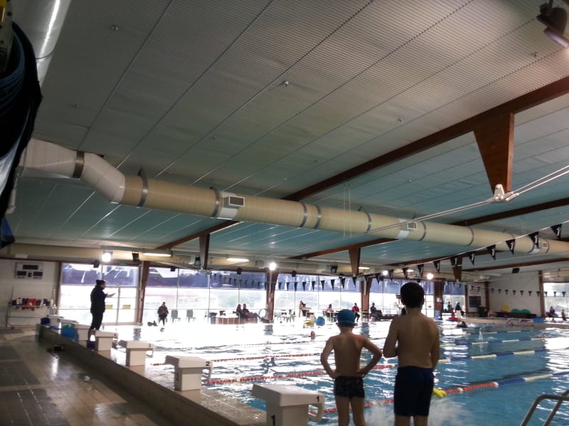

Here's an example, I believe this was retrofitted after the portals sagged too much due to the humidity and temperature in the pool. Epoxied dowels installed to the underside of the beam from memory.

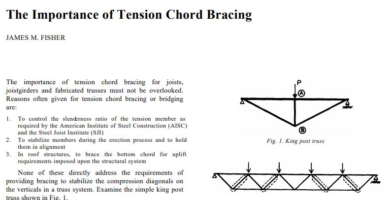

Another finer point regarding the bracing: for full span, lateral torsional buckling, the effective depth of the beam is likely to be the distance between the top of the beam and the tension rods. This may change the calculus on whether or not conventional top flange bracing is actually effective for LTB (60% depth framing tying in etc). At the least, it warrants a little extra consideration. The king post truss is actually the classic example for the need for truss bottom chord bracing as discussed here: Link

jayrod12 said:
...how was that provided in the pool example you posted? It seems rotationally quite flexible.
I can't resist speculating on some options because, well, it's super interesting:
1) Some serious beam torsional restraint offered by whatever's in the ceiling.
2) The raw weight of the big triangle things may well be enough to tip the stability scale in the right direction given that LTB rotation will be constrained to occur at the level of the roof deck.
3) The super clever mechanism shown below which, alas, has a tradeoff. There's no free lunch in Newtonian physics.
From a rotation perspective, I assume the beam is rotationally restrained at its ends, but the only continuous bracing is lateral at the top surface. Perhaps rotational restraint, such as fly braces, is possible? In such a case, though, I would be surprised to see a large moment at #1 I see now that there's lateral bracing at Location #1.
Looking at the drawings I have they had 900 deep rafter with 450 deep purlins framing into the sides of the rafters from each side. So presumably they utilised these to take out any rotation (no detail provided on the end connections to these, but wedged between 2 x 450 deep purlins would go fair way towards limiting any rotation I would say even with fairly nominal connections).
Not my design so I cannot comment further on design apart from what is implied, I only did a condition survey of the entire complex many years after these fixes were in place. According to the drawings the repairs were due to some delaminations in the glulam as well as the deflection issues I noted earlier.

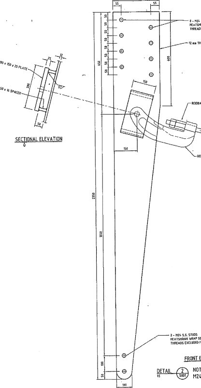

Kootk, they had these plates which took the beam axial reaction more or less back to the CL of the rafter with a smaller point load further down the column.
Sweet... thanks for sharing that Agent. Any chance you've got the detail where the rods hit the beam ends?
