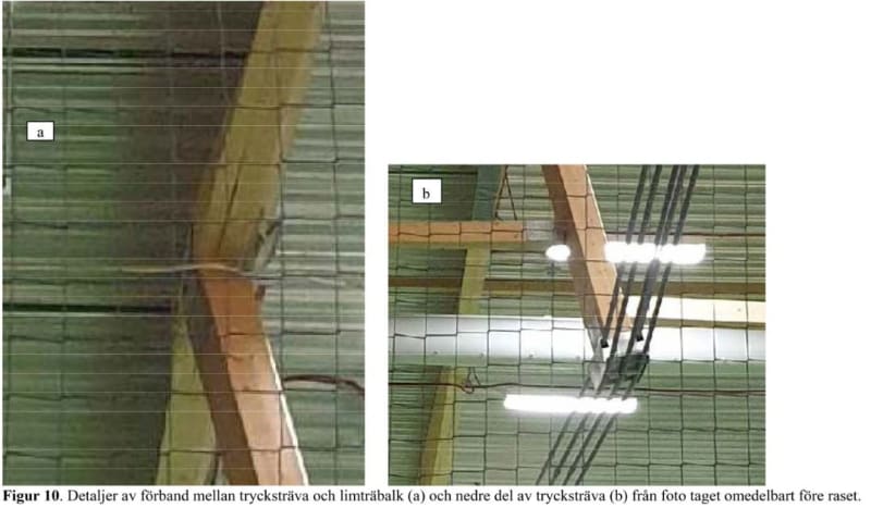

I'm going out on a limb and guessing this is about a failure in Kiruna, Sweden. There's a preliminary report on the failure by a university. unfortunately just in Swedish.
The failure is also being investigated by The Swedish Accident Investigation Authority (SHK), but no report is finalized. The procedure can be followed at link below, in English.
Sorry again... I thought it was his model, not a real structure.
Dik,
It is the op's analytical model, not a real structure, I believe.
Oof. Well, ThomasH is Denmark, so it's certainly plausible that he'd be looking into a failure in Sweden. Sadly I'm 4 generations from Sweden, and posses none of the language. Picture's worth a thousand words though:

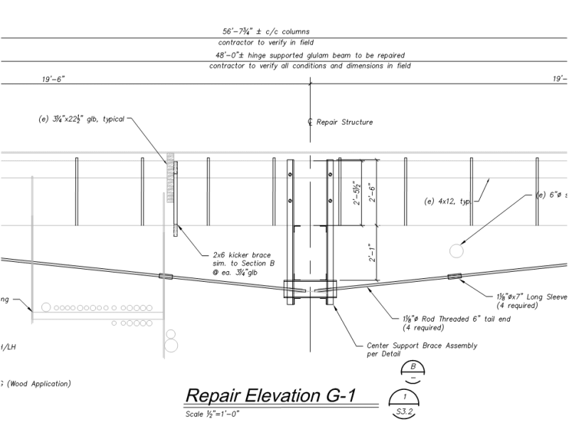

I know this is a later entry, but while looking for something else came across this post. To the original OP Thomas. I hope you've found the assistance you needed in your review and analysis. To answer your question, 'are there US codes addressing these structures with relation to Glulams'-No, I do not believe there is. The information you will find here are based upon glulam repairs, not bow string truss methodologies since you do not use such large glulam members intended with 100% flexural capacity intention. One company uses a technique exactly as described by dhenger above and the other using horizontal post-tensioned cables stanchioned very close to the bottom laminates,...as if to act as additional laminates for the beam and only slightly effecting the neutral axis of the retrofit. The later design repair technique and configuration of course not related to your post.
Thus agreed with a tough design repair challenge using even a FEM model with the intent on modeling the true structure to resist all loads as if it were a bowstring truss. In doing so, the forces in the rods are incredibly high. Thus begins the attempt to deepen the central strut to increase the moment couple which intern decreases the forces in the rod. However this increase the vertical component forces in the strut due to the geometry as well as mentioned by all above, adding to the lateral instability at the both the bottom of the strut and at the top of the strut at the connection at the glulam. You've essentially now an unbraced column continuous beam over a column cap, it needs to be braced at that location or gusseted somehow in the form of a saddle or the beam itself will require bracing laterally within a reasonable distance from the concentrated load say 1/2 the glb depth or so. But truly, the tension connection at the bottom of the struct should be braced as well. With any appreciable out of plane movement at the bottom of the strut, I'm not sure any shallow connection at the glulam would resist the induced moment forces. From the photo, it would appear although this obvious, the strut connection rotated, split the member, crushing the parallel fibers in the process. A deeper saddle connection with through bolts higher on the beam may have helped this situation if a beam brace at that location was not feasible or desirable. Or a full wrapping saddle even better, no through bolts. I believe this style of repair, by nature of a now lower neutral axis, theoretically reduces the tension in the bottom plys of the glb but puts more of the plys into compression than before, granted at reduced measure but how does this effect unbraced lengths effects? Thus also the importance of addressing the lateral braced lengths especially of deeper glulam beams.
Per dhenger's post again, most of these 'designs' with such large glulams are 'repairs'. Thus no representing codes or design manuals addressing how to design these structures as original structures which are so unreasonably balanced. They frankly would never be considered economical and the problems everyone has aforementioned bring reason to why this is so. Actual tension in the steel rods hard to quantify in the field without strain gauges, special inspection and qualified crews. Enough torsion is typically applied to the rods in order to resolve deal load deflection issues. Calculating the load required to create a 1" deflection in the beam can perhaps estimate how much load is actually in the rods as well as help you determine how much strength you have given back to the beam, increasing its capacity by some measure, hopefully to the point that includes any remaining dead load and the member design live loading.
A similar repair image included below for what sounds like a smaller glulam beam repair: The center strut connection shown only. This repair connection by nature of the saddling angle extensions resolves some moment which may occur at the strut connection to the beam. Additional lateral bracing was added to the bottom of the glb at every sub-girder connection along its length.
