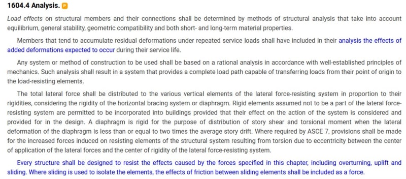

To me the design philosophy is either the eccentricity is in the column, or it's in the connection, applying it to both would (typically) be conservative but it needs to be handled in at least one sense or another. (in other words, the eccentricity, which physically exists), needs to be handled via equilibrium and "well-established principles of mechanics."

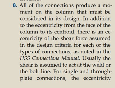

Column Connection Eccentricity, Carter, Steel Interchange, Modern Steel Construction, November 2002.
One might be able to find less dated references.... (by the by, my general method here is to type "bla bla bla Modern Steel Construction" (e.g. eccentricity in column design Modern Steel Construction) into Google and hit go. I can vaguely recall most of these topics, but the specifics elude me. Hence my reliance on the search engine.
'...must be considered in the column design' does not mean 'must apply a moment at the top of the column'. Rationalizing whether the column actually sees and needs to be designed for moment is 'considering the eccentricity in the design'
