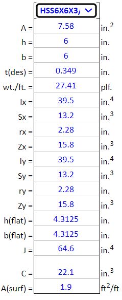

From AISC database for HSS 6x6x3/8, the flat is 4.3125 approx... and I'd call it a fillet weld.
Not my size...I have a 6x6x1/2. But what Kootk said is what I need.
