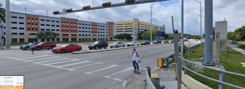

I'm assuming it's all ramped to allow skateboarding from apartment to class with only a few short flights to do stunts across.
"should I climb three flights up and three flights down"
I thought the original had an escalator and a lift(elevator) for those of limited mobility?
Also it has a roof on so you can keep cool / dry as required.
However from this photo you might be right about the skateboard.
The only evidence that anything happened here is the one remaining stump. The one on the other side seems to have been demolished.
No plaque, no remembrance stone, just some graffiti.
