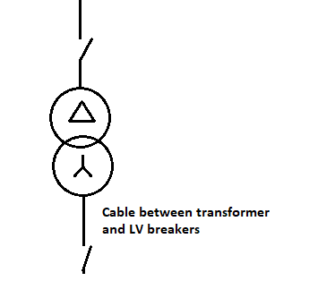

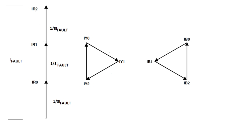

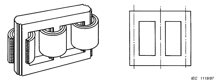

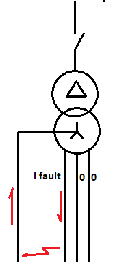

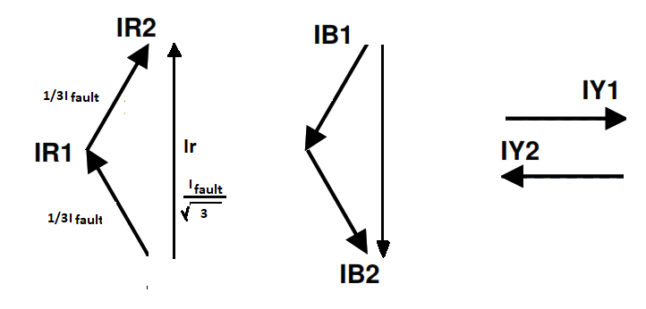

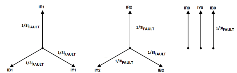

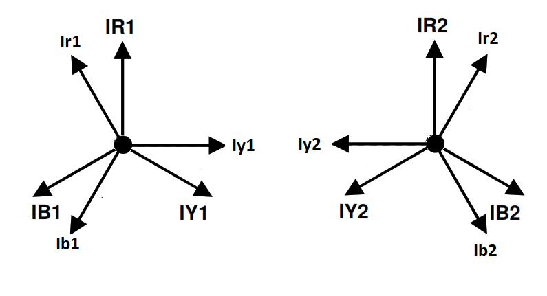

I am faced with having to work out the maximum distance the LV breakers are allowed to be from the transformer and have written the attached paper to try and get things sorted. Does anyone see a mistake, have any references they can offer or can offer any alternate views.
