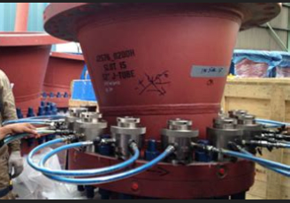

How hydraulic bolt tensioners work. These all directly tension the body of a bolt or stud.
There is also Hydraulic Torque Wrench. These are functionally the same as a torque wrench, with hydraulic power added. They apply tension the body of a bolt via the inclined threads (indirect tension).
Both have their place, but not the same place.
If the hydraulic tensioner will fit and you are able to get the required thread engagement (note the above) the method can be used. Tapped holes do not concern me unless the base metal is soft - like aluminum - then more care is required with both methods.
Pay attention to tightening sequence, see below for one option.

1)The blind tapped hole (see ASME VIII-1 Figure UG-40 (a-1) and (a-2)) is the same as the drilled hole when the stud is tensioned.
2)You need to calculate the elongation of the stud (mm)
3)Never use torque, it's an inaccurate system. Torque requires lubrication but not for elongation.
4)Try to use the tensioner on all the studs at the same time. Otherwise you need various sequences.
