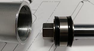

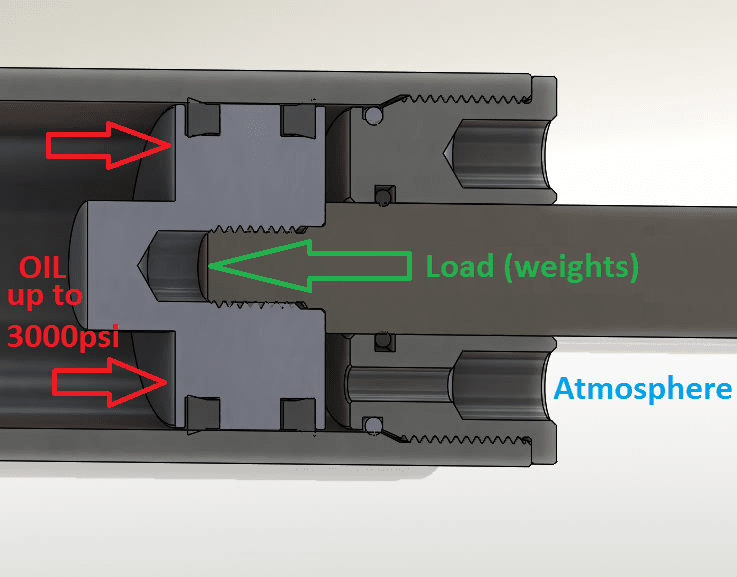

I'm trying to fix a hydraulic cylinder seal leak where the fluid has 1 entry/exit at 3,000psi and the other side open to atmosphere. There 2 U cup shaped seals (loaded with O-Ring) with a back to back configuration. I believe this creates a pressure trap and causes premature failure of the seals where hydraulic fluid leaks pass both seals. What's the best option to fix this? I was thinking about:
1. adding an O-Ring between the back to back seals
2. Replace the 2 U cup seals with O-Rings and add a U Cup seal in the middle
3. Switch both U cup seals towards the high pressure side (flip the direction on the rear seal)
4. Remove/Unload the rear O-ring on the atmosphere side to unload the seal

It seems that this is a piston seal on a double acting cylinder and was not designed to be drip-free. If oil is expected on both sides, there would be no concern about a few drops passing. These are pressure energized seals. Having two seals in series makes it indeterminate as to what is the pressure across each seal. They are most likely to leak when there is no pressure to activate the seal, and it looks like in your application there is often no pressure on the seal.
Compositepro, the seals are o-ring energized to preload the seals to prevent low, or no pressure leaks.

There are premature seal failures much more than a few drops. The air side is just atmosphere, basically there is a hole in the end cap of the cylinder.
I'm thinking of either removing the low pressure side o-ring or change the direction of the rear seal so both seals are pointing to the high pressure side, any recommendation on which is better or maybe a double lip seal?

Walls look fine and cylinder is made of anodized aluminum. I should note that the leak is noticeable after about 300 cycles.
The seal geometry does not look right. It appears the the seal can wiggle considerably as the piston moves back and forth. I think a metal spring energized cup seal would probably work better by retaining it shape better and having a better wiping geometry for preventing passing of the oil film. The sharpness of the lip in a lip seal is very important to its function.
One other factor to consider is that the surface finish metal surfaces sliding on plastic is very important. Too highly polished is often worse than too rough.
Is this cylinder your own design and construction? The reason I ask is that there are many design details in engineering that are subtle and learned through tribal experience and years of product history. Starting from scratch is like reinventing the wheel.
How are side loads on the piston rod handled. It appears that wiggling the piston rod will change the shape of your seal. That is, your seal is actually being used as a bearing for the piston.
I inherited this custom cylinder design and my hydraulic experience is limited. My predecessor was more of a trial and error type. The dimensions for the seal grooves are from Parker seal design reference book. The surface finish is more on the highly polished side. The side loads are handled by an endcap threaded into the cylinder with a .0005"-.0020" of of diametrical clearance. The rod is 0.5" dia and cylinder ID is 1.25".
The "highly polished" finish may be too smooth and allowing too much carryover.

Have you removed the seals from the piston and inspected them under some magnification to look for damage? Even a simple magnifying glass can help.
Are they being damaged at some point before they are installed?
Have you removed the seals from the piston and inspected the seal groove closely? If the seals are being installed and removed using a sharp steel pick, this can easily damage the groove. A brass pick can be used, unless it's an aluminum piston, but a plastic pick or wooden popsicle stick is gentler.

The need for a bearing ring may be significant.
O-rings with backup rings or X-rings with backup rings should work pretty well in this application. The seal orientation you have should not trap much pressure. If you only ever have pressure on the fluid side, then drilling a hole from the side opposite the rod into the seal groove will allow fluid to escape back into the fluid cavity while maintaining sealing. That will work with an O-ring, but probably not with the type of seals you are currently using.

I removed the seals with leaks and there does not appear to be any damage under a 10x magnification.
The seals are installed clean as they are installed with a tool to prevent any damage.

I should asked if there is a better setup/way to test for seal leaks? I currently use a motor to drive a handle to pump fluid in 1" increments until the rod is fully extended (about 8 pumps) with a 300 pound load and a 15°-45° incline as the rod gets extended. This would be done about 1,000 times to check for leaks. The leaks seems to accumulate if left under load but not actually pumped over a long period of time (2 month).
What is the fluid?
What is the seal material and hardness?
Is the load supported?
I'm confused. You pump in fluid to extend the piston? Your illustration shows fluid retracts the piston.

Here is some labels that should help, the fluid has the same entry and exit point with a check valve, the piston is pushed/extended when fluid is pumped into the cylinder and retracts from the force of the load when a valve opened.

Can you elaborate on this setup? If the issue is that it allows a tablespoon or two of fluid to pass through over a few months under load, I don't think that that is unexpected.
You may want to turn your system upside-down so that the rod end port is facing down and fluid leakage comes out of the port as it leaks. Leave it under load and check to see if you are experiencing the same leak rate on day one as you have on day sixty.
