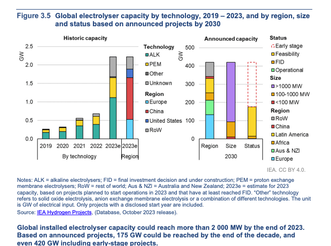

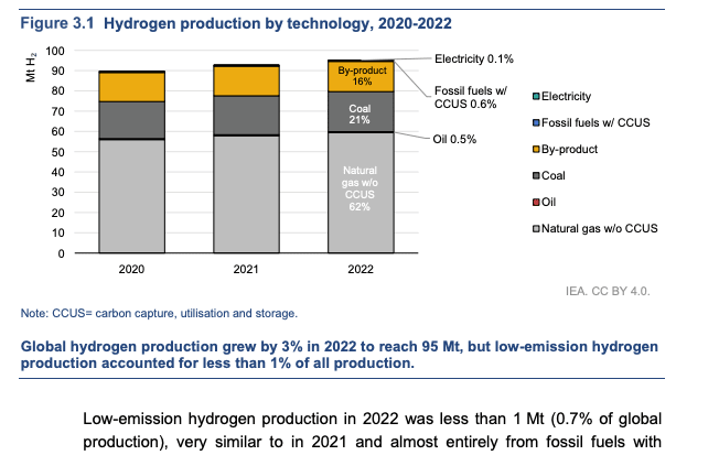

... and needless to say those are still valid objections. Here's what the hydrogen peeps at IEA say
and somehow we are going from 2 GW in 2023 to 400 by 2030
