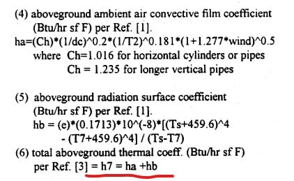

Ok, i don't know why but everywhere i see they calculate the radiation and convection outside thermal coefficients as series not as parallel like here:

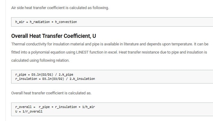

also here:
anyway now with this calculation i am getting a U of 15 W/m^2*k instead of 12. i think its good
Any thoughts why it is like this? , thank you
2 processes competing outside, Convection and radiation .
Pierre
