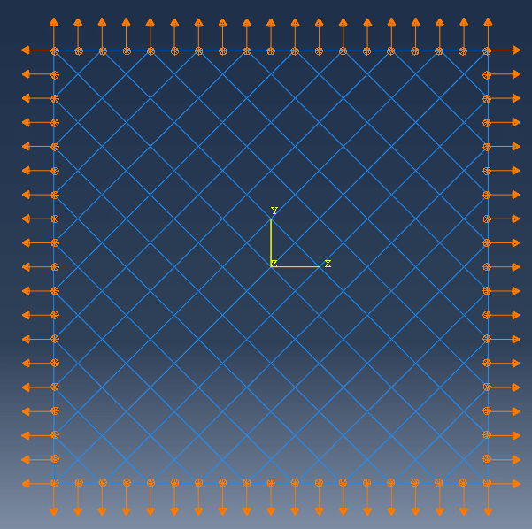

Hello Everyone,
I have modelled a net with following parameters:
Net elements: Truss(T3D2) - hyperleastic
Frame: Beam(B31) - linear elastic
BC: constraint: DispXYZ=0 at two side of the frames
load: 1G gravity which is normal to net
Step: General static, nlgeom=on
It is a pretty straight forward analysis. I want to analyze hyperelastic net under gravitational load. However it doesn't converge (due to numerical singularities). Could you please check attached inp file and advice me? It is a very small model, it shouldn't take more than 1 minutes to solve. Thanks in advance.
OK, without looking at it. Since you have subdivided the trusses we have a link mechanism between each one of them so that will not solve. Typically one will have some pretension in the trusses before adding an out of plane loads, because if they do not have tension they cannot take the out of plane load (this is what is called a geometric non-linearity or tension stiffening terms). So in your first step (before gravity comes on) just add in plane disp. in the opposite direction at the BC and stretch the net a bit. (In short they/trusses need a pre tension)
I checked this model in Abaqus and I agree that this is because of the lack of pretension. You can add Predefined Field to the Initial step, select Stress type and enter some small value for Sigma11.
Thank you for the suggestion. The thing is, two different material is used in this net assembly. Inner net is hyperelastic material with very small stiffness. On the other hand, frame is made of steel (relatively high stiffness). Thus if I apply large displacement, experience high stress values on the frame. If I apply small displacement values, analysis aborts with same error. Could you suggest me a method for applying axial loading to hyperelastic material, without affecting steel frame?
I ran it with a small initial stress of 5 MPa applied as described above to the set consisting of truss elements only and the analysis worked without any problems.
Just add for example:
*Initial Conditions, type=STRESS
Set_name, 5, 0, 0
I can confirm also that it solves without any problems (eventhough I had to use less elements- have a node limited version:)).
Pretension for initial conditions solved my problem. Thank you for your help.
