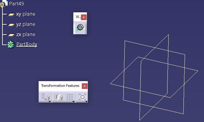

I cannot activate the transformation icon on my Catia V5 R20. I went to tool and selected Customize,Toolbars and selected restore all contents, ok and then restore position ,ok and close. This did not solve the issue?
It will activate when I'm in the customize window only but once I close it the icon deactivates. i'm run Catia on a Pro Mac Book with an intel processor through bootcamp.
No content in active body it will be deactivated.
↓No Content in Active Body↓

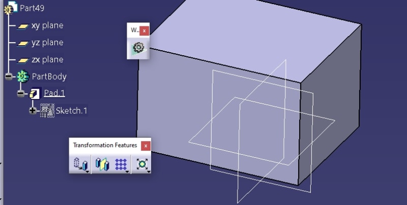

↓Content in Active Body↓

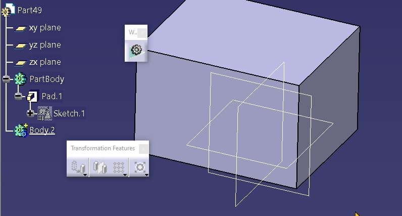

↓No Content in Active Body, but content in a different Body↓
the body is Active. There is a glitch that will not let me activate the transformation icon in the Part design workbench?
