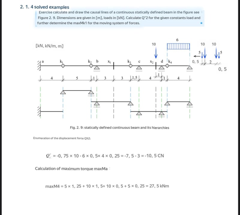

Dear Sir/Madam,
I really hope that my question reaches someone, but if you are reading this, I will be immensely grateful to you. I would really like to understand how to solve such tasks.
I study at the university at the Faculty of Civil Engineering. I really need help from you if you are good at conducting cause-and-effect relationships in such drawing tasks in the subject Analysis of building structures.
The assignment is written in Czech, but I will translate it into English to make it more convenient:
Determine and plot the waveforms of the causal lines
Mf, Rb, M1, Q1 and Qdc.
Do not bind to shear.
(To check you need advice of all causal lines calculated in points I and II).
Your coefficients for the ANKC course:
a=0.700 , b=1.200 , c=1.400
I have attached a photo of the tasks below
Thank you so much for reading this. All the best and have a good time of day.

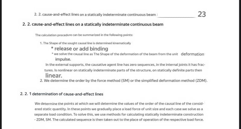

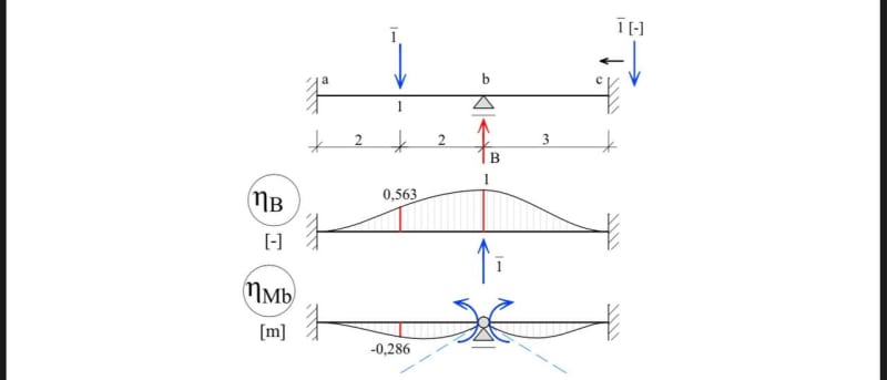

I have more of a question like this: how would I define numerical values of causal lines on statically undefined constructs. Due to not knowing how to calculate this, my progress on the problem has come to a halt.[sad]
I send a screenshot from an example of statically determined casual lines[wink]

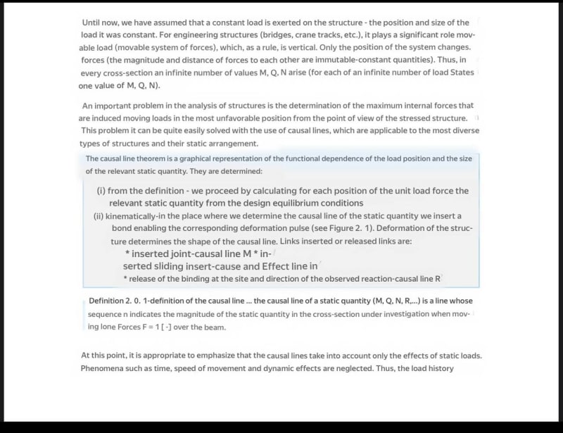

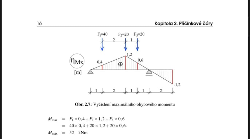

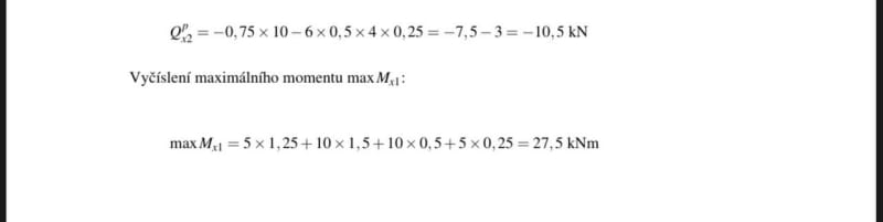

I will send you screenshots of my materials from the university[dazed]
So my interpretation is that a causal line is a plot of a selected property at a particular point (?) along the beam, as a function of the location of the force applied to the beam. The ? is because I would have thought knowing the max bending moment anywhere along the beam is more useful.
Anyway, fundamentally you are trying to solve the SF and BM diagram for one particular location of the force and then generalising it. So you know how to do the first part of that?
