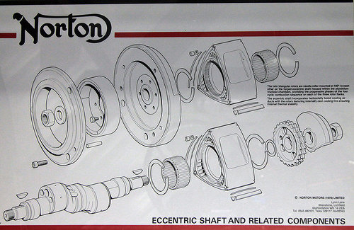

I did a bit of research on the Midwest/Norton rotary. Wikipedia has scant information ( but does mention the Midwest is closely related to the Norton for which more information is available. Here's a picture of the Norton's guts...
I see a lot more than three moving parts in that image, and that's of the engine alone sans accessories such as the oil pump, starter, and generator. Eliminating accessories from the comparison is silly IMHO as they are all part of the final system. My engine as shown includes all necessary accessories except the battery and fuel tank, and I feel part of its attractiveness is the synergy attained between the accessories and the ICE components proper. Granted, my engine isn't running yet (much less demonstrating the desired performance), but the *concept* stands up well under comparison in my humble opinion.

The AR-741 Wankel that you cite was developed from the Midwest rotary which in turn was developed from the Norton rotary . I should of course mentioned that the 3 moving parts are of course assemblies not just individual components.

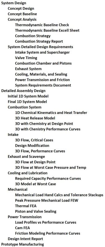

My consultant has checked all my work and found it to be complete and "within plus or minus a few percentage points." As I noted, he's currently doing an independent top-down analysis just to be sure. Assuming his conclusion regarding my analysis holds up after he finishes his own top-down analysis, we'll move into more sophisticated modeling and simulation.
No offense, but I'm going to have to go with my consultant's opinion over yours. It's what I pay him for. He has the entire set of design and analysis files which you don't have. I'm confident you know what you're talking about when it comes to engines, so I assume the errors are being introduced in my poor communication of the design.

The plan:
Yes the quote is a correct analysis. However, with the exception of variable compression, there is nothing in the OP design with or without stepped bore (in terms of PV and work) that could not be accomplished with a single piston - especially one which is cam driven.
