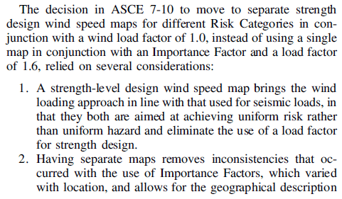

From IBC 2012:

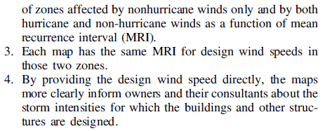

From Guide to the wind Load Provisions of ASCE 7-10:

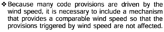

From ASCE 7-10 Commentary:
The difference between sqrt(1.6) and sqrt(0.6) is something that a lot of engineers seem to accept as an acceptable 2% difference, why make a big deal?. Fair enough, the calculated values are very close.
However, insignificant as this difference might seem, the reason behind it should not be a mystery.
On the one hand, IBC makes it clear that the conversion they specify is to be only used when using the provisions of specified standards. Standards that directly refer to ASCE 7-05 basic wind speed. For example, TIA-222 has an exact copy of the ASCE 7-05 basic wind speed map in their code, and they also use a 1.6 factor on the wind. So, based on this one example, I would conclude that IBC is attempting to convert the ultimate wind speeds to allowable wind speeds (ASCE 7-10 to ASCE 7-05). Seems clear enough. This conversion is done by multiplying Vult by sqrt(0.6), according to the IBC.
Now, on the other hand, ASCE 7 is using sqrt(1.6) and they fortunately provide some additional explanations for why sqrt(1.6) is used. The 1.6 comes from the load factor for strength design in ASCE 7-05 and is the wind load ratio between 7-10 and 7-05.
The ASCE 7-10 Wind Guide makes it clear that designs using 7-10 Fig. 26.5-1A wind and designs using 7-05 Fig 6.1 are the same, assuming we are talking about strength design and each uses the corresponding load factors.
By this logic, 1/sqrt(0.6) = 0.36+0.1ln(12T) gives a value of T = 920, a little bit more than the 709 we get with sqrt(1.6).
So, why does IBC 2012 use the sqrt(0.6) and ASCE 7 use sqrt(1.6)?
