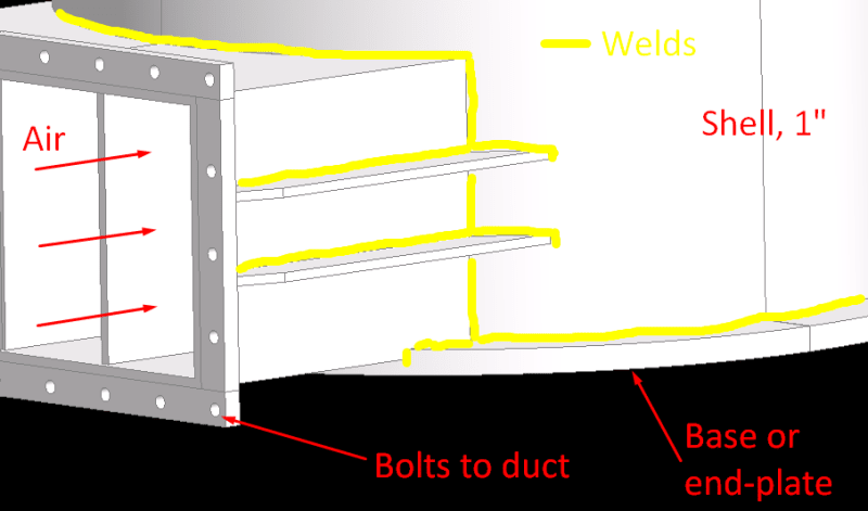

Greetings Experts.
I am a new FEA engineer and have been tasked with a simple FEA analysis of a pressure containment vessel at 120 psi. The vessel has passed the EN 13445 standard but also needs ASME certification. My senior colleague has completed the ASME VIII Sec 1 calcs to approve the design. However, he's asked me to have a go at FEA and treat this task as if there was no ASME report to play with.
Material of Construction: SA240 ASME Stainless Steel 304L
Outlet flange thickness: 3/4"
Base thickness: 1"
Outlet duct plate thickness: 3/8"
Shell thickness: 1"
Rib thickness: 3/8"
Questions:
1. How should the flange be appropriately constrained?
If I constrain the bolt holes or flange face, the stresses will increase. If the flange is left unconstrained, I may have unnecessary deflections.
2. Should I model welds?
Since the welds are all butt welds, if I treat the structure as a bonded continuum, would that drastically increase stiffness. I've read that good butt welds and penetration welds have equivalent stiffness as the parent material, including the HAZ.
3. Sub-modelling welds and ribs
How relevant it is to model welds on ribs as I expect stress concentrations to occur at the base of the ribs
4. Is pressure compensation important since I'm leaving the exit open? If not, do I need to cover it with a plate of relevant thickness?
Thank you.

I hope this pic helps
My mentor is not a mentor, but an elderly person who has no FEA experience. Also, the firm is relatively small and I have just taken a basic FEA course to begin with.
I believe my answers lie in my own engineering judgement and further reading, else garbage in = garbage out.
A1. Since the long ducts are suspended from ceiling hooks, flanges for the inlet and outlet need not be rigidly constrained.
A2. Since the welds are not expected to fail, treating the welds as a continuum would suffice.
A3. I can sub-model the components, just to note areas of high stress concentrations

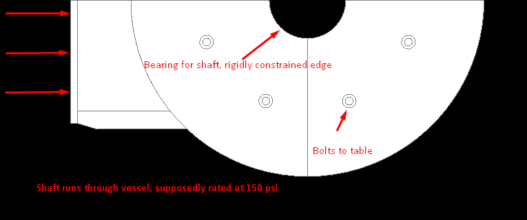

A4. I may have misunderstood pressure compensation, if it exists (using constrained bodies as a boundary condition when the vessel has openings). I heard the term in this video (@ 20:00 mins). In my case - since the vessel has a shaft that runs through its center, the bearing areas of the shaft ends have been constrained rigidly. (bottom view below)

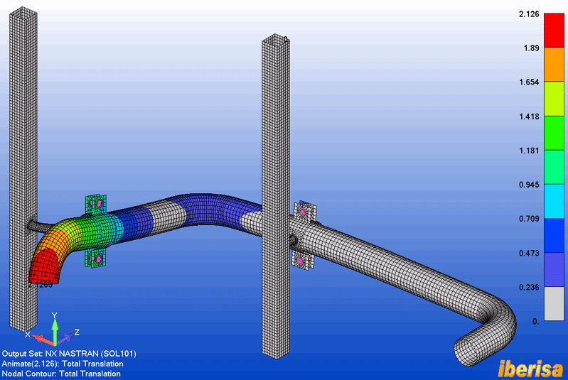

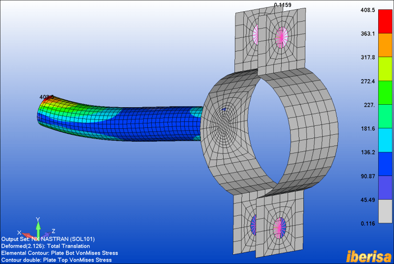

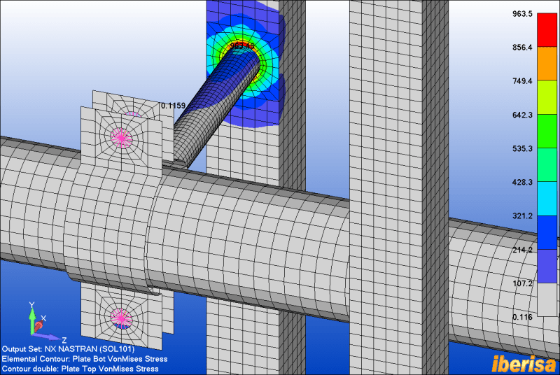

Is very easy, you have two options:

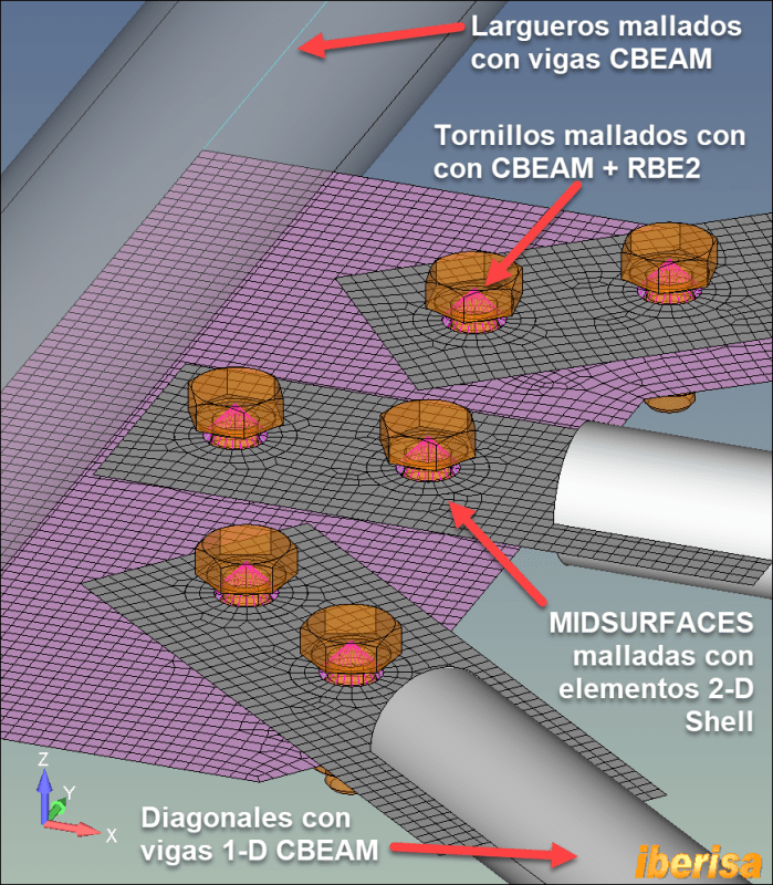

1.- Create the MIDSURFACE of the flange with holes to mesh with 2-D Shell CQUAD4 elements and define an spider of rigid RBE2 elements and in the center node prescribe a pin constraint (TX=TY=TZ=0) simulating a pin joint where the bolt is located. This way you can compute the reaction forces in the pin constraints, and use the reaction forces values to dimension bolts.
2.- Include in the Finite element model also a portion of the outlet duct (constraint the end duct), and discretize both flanges with two midsurfaces with holes including the bolts: mesh the bolts with CBEAM elements with spiders RBE2 elements at both ends, and define contact surface-to-surface no-penetration between both flanges.
Some examples here of flanges meshed with 2-D Shell CQUAD4 elements and bolts with CBEAM elements:
I hope the above examples show you how to mesh flanges.
Also in this video you have the way how to mesh bolts between two plates:
Best regards,
Blas.
